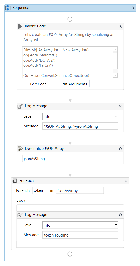

This is how the automation process can be built:
  1. Open Studio and create a new Process.
  2. Drag a Sequence container in the Workflow Designer.
  3. Create the following variables:
    Variable NameVariable TypeDefault Value
    jsonAsStringString
    jsonAsArrayJArray
  4. Add an Invoke Code activity inside the Sequence.
    • Select the Edit Code button and add the following code in the opened window:
      Dim obj As ArrayList = New ArrayList()
      obj.Add("Starcraft")
      obj.Add("DOTA 2")
      obj.Add("FarCry")
      Out = JsonConvert.SerializeObject(obj)
    • Once the code is added, select the OK button.
    • Select the Edit Arguments button and add the following argument:
      ArgumentDirectionTypeValue
      outOutStringjsonAsString
    • Once finished, select the OK button like in the following GIF:
      docs image
  5. Add a Log Message activity after the Invoke Code activity.
    • Add the expression "JSON As String: "+jsonAsString in the Message field.
  6. Add a Deserialize Json Array activity after the Log Message activity.
    • Add the variable jsonAsString in the Json String field.
    • In the Properties panel, add the variable jsonAsArray in the JsonArray field.
  7. Add a For Each activity after the Deserialize Json Array activity.
    • Add the value token in the ForEach field.
    • Add the variable jsonAsArray in the VB expression field.
    • In the Properties panel, in the TypeArgument field, make sure you chose JValue.
  8. Add a Log Message activity inside the Body of the For Each activity.
    • Add the expression token.ToString in the Message field.
    This is how the workflow should look:
    docs image
  9. Run the process. A JSON array is created, deserialized as a String and provided as a list of extracted tokens.
