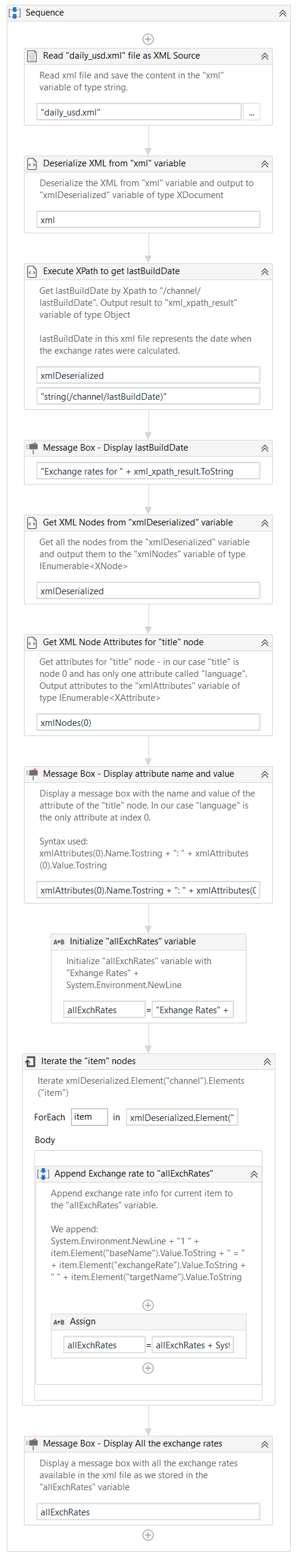

  1. Open Studio and create a new Process.
  2. Drag a Sequence container in the Workflow Designer.
    • Create the following variables:
      Variable NameVariable TypeDefault Value
      xmlString
      xmlDeserializedXDocument
      xml_xpath_resultObject
      xmlNodesIEnumerable
      xmlAttributesIEnumerable
      allExchRatesString
  3. Add a Read Text File activity inside the Sequence.
    • Add the expression "daily_usd.xml" in the File Name field.
    • In the Properties panel, add the variable xml in the Content field.
  4. Add a Deserialize XML activity after the Read Text File activity.
    • Add the variable xml in the XML String field.
    • In the Properties panel, add the variable xmlDeserialized in the XMLDocument.
  5. Add an Execute XPath activity after the Deserialize XML activity.
    • Add the variable xmlDeserialized in the Existing XML field.
    • Add the expression "string(/channel/lastBuildDate)" in the XPath Expression field.
    • In the Properties panel, add the variable xml_xpath_result in the Result field.
  6. Add a Message Box activity after the Execute XPath activity.
    • Add the expression "Exchange rates for " + xml_xpath_result.ToString in the Text field.
  7. Add a Get XML Nodes activity after the Message Box activity.
    • Add the variable xmlDeserialized in the ExistingXML field.
    • In the Properties panel, add the variable xmlNodes in the XMLNodes field.
  8. Add a Get XML Node Attributes activity after the Get XML Nodes activity.
    • Add the expression xmlNodes(0) in the Existing XML Node field.
    • In the Properties panel, add the variable xmlAttributes in the Attributes field.
  9. Add a Message Box activity after the Get XML Node Attributes activity.
    • Add the expression xmlAttributes(0).Name.Tostring + ": " + xmlAttributes(0).Value.Tostring in the Text field.
  10. Add an Assign activity after the Message Box activity.
    • Add the variable allExchRates in the To field.
    • Add the expression "Exhange Rates" + System.Environment.NewLine in the Value field.
  11. Add a For Each activity after the Assign activity.
    • Add the expression xmlDeserialized.Element("channel").Elements("item") in the Values field.
    • In the Properties panel, select the System.Xml.Linq.XElement option from the TypeArgument drop-down list.
  12. Add an Assign activity inside the Sequence container of the For Each activity.
    • Add the following expression in the Value field: `allExchRates + System.Environment.NewLine + "1 " + item.Element("baseName").Value.ToString + " = " + item.Element("exchangeRate").Value.ToString
      • " " + item.Element("targetName").Value.ToString`.
  13. Add a Message Box activity after the For Each activity.
    • Add the variable allExchRates in the Text field.
      docs image
  14. Run the process. The XML file is read, deserialized, and accessed. A few message boxes are displayed with information extracted from the file.
