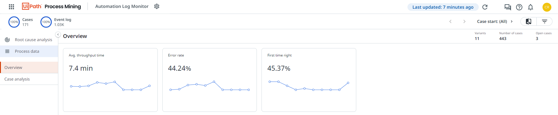

Overview dashboard
The Overview dashboard can be used to get a global overview of the data. It provides high-level case information.
Cases
Every single time an automation job is executed, it is considered as one case. A case (case id) is represented by a specific Job ID run. The cases displayed in the Automation Log Monitor are derived from the automation that was selected for the Automation Log Monitor when it was created.
KPIs
The following table describes the KPIs that are displayed on the Overview dashboard.
| KPI | Description |
| Variants | The number of various process paths different cases have taken from end to end. A variant is a specific path through the process, a set of activities that were taken in a specific order. Usually, several cases have followed the same variant. |
| Number of cases | The number of unique cases created during the selected period. |
| Open cases | The total number of open cases within the selected period. |
Dashboard charts
The following table describes the dashboard charts of the Overview dashboard.
| Chart | A history graph that displays... |
| Avg. throughput time | The average throughput time for the end-to-end process. |
| Error rate | The percentage of cases that executed with one or more errors. |
| First time right | The percentage of cases that executed first time right. |

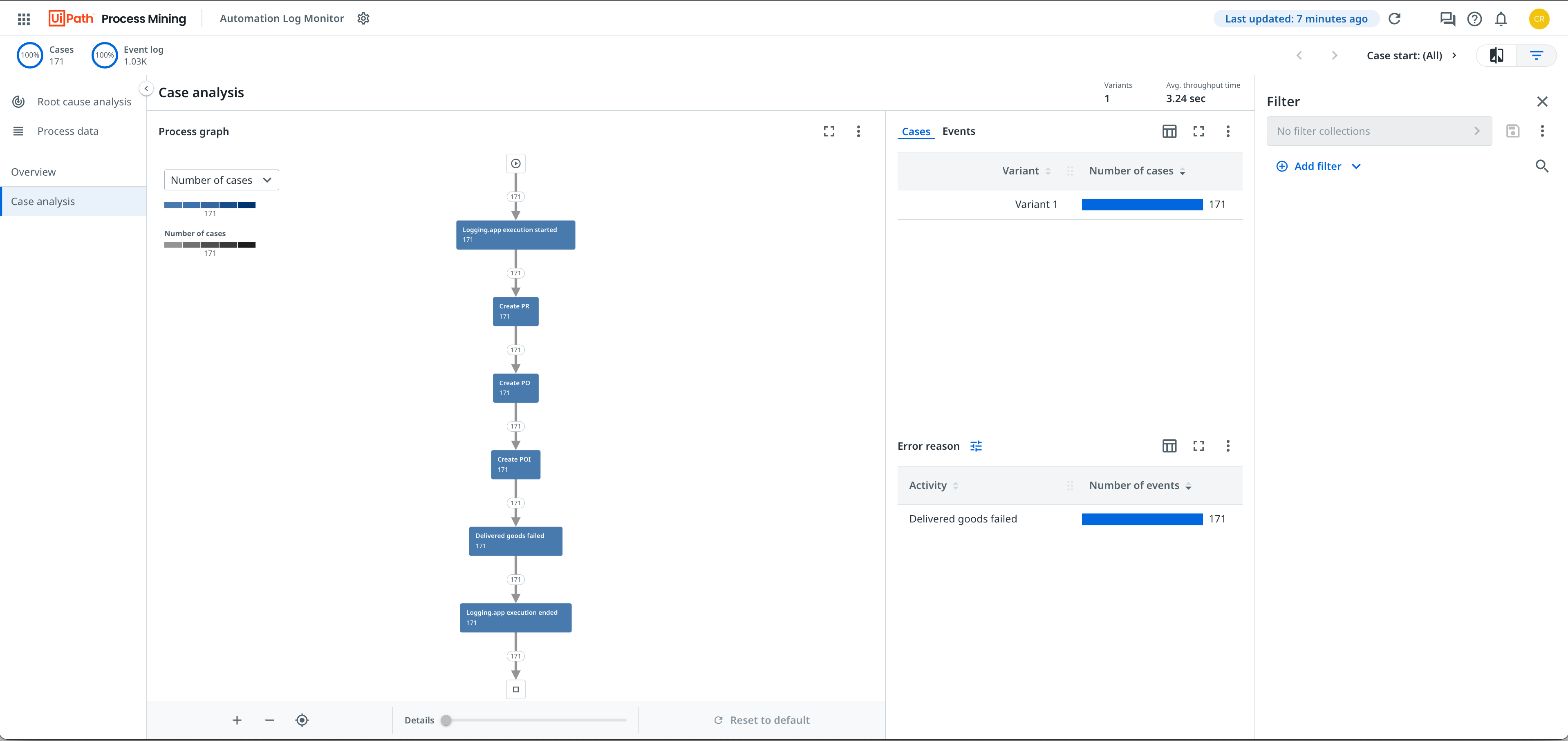

Case analysis dashboard
Case analysis is the main dashboard where you can analyze the overall process.
KPIs
The following table describes the KPIs that are displayed on the Case analysis dashboard.
| KPI | Description |
| Number of cases | The number of unique cases for the end-to-end process. |
Process graph
The process graph displays the end-to-end process based on the number of cases.
You can select a different metric from the metric selector to display the process graph based on a different metric. The following table describes the available metrics.
| Metric | Description | Base |
| Number of cases | The number of unique cases. | Cases |
| Avg. event throughput time | The average throughput time for the end-to-end process. | Event log |
| Total event throughput time | The total throughput time for the end-to-end process. | Event log |
Cases and Events
The Cases and Events bar charts enable you to monitor the various aspects of the automated process. You can change the data in the bar charts by selecting the different fields and/or metrics.
Every single time an automation job is executed, it is considered as one case. A case (case id) is represented by a specific Job ID run. An event refers to an action or occurrence during the automation run. Each event is represented by a corresponding Robot Log message associated with a Job run.
Error reason
The Error reason chart displays the number of events for activities that represent errors in the process.
