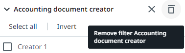

Removing individual filters
Follow these steps to remove an individual filter.
  1. Go to the Filter panel and locate the filter you want to delete.
  2. Select the delete icon Delete icon
    Remove filter

Managing filter collections
Follow these steps to manage existing filter collections.
  1. In the Filter panel, select the More icon next to open the drop-dwon menu
  2. Select Manage filter collections.
The Manage filter collections dialog is displayed. Here you can edit the Name or the Description for a filter collection, or you can delete the filter collection.
Changing the name or description of a filter collection
Follow these steps to edit the name and/or the description of the filter collection.
  1. In the Manage filter collections list, locate the filter collection for which you want to change the Name or Description.
  2. Select the Edit icon.
  3. Edit the Name or Description as desired.
