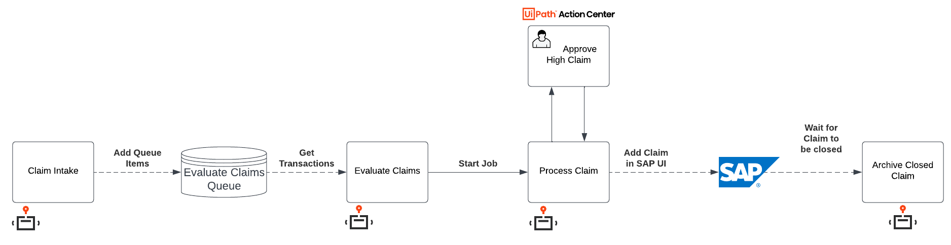

Claim processing example
Let's consider a Claim Processing Example, which involves four different automations.
Automation
Description
Claim Intake
A Dispatcher built using ReFramework. It runs every morning, and each new claim received is added to a Queue as a Queue Item.
The task linked to this step, has a reference to the JobID that was executed.
Note: Claim Intake is linked with Evaluate Claims through a Queue as Dispatcher Performer.
Evaluate Claims
A performer built using the ReFramework. It runs every midday and processes every queue transaction. It performs multiple checks, and if it passes all evaluations, a job is started to process the claim.
The task linked to this step, has a reference to the QueueItem that was executed.
Process Claim
Long running workflows that raise an Approval Action Center task (Approve High Claim) if a high claim is processed. Once the approval step is completed, the claim is added to SAP.
The task linked to Approve High Claim task, has a reference to the TaskID that was executed.
Note: Process Claim is an automation started by Evaluate Claims using Start job.
Archive Closed Claim
Every end of week, the automation runs and retrieve every claim from SAP with status Closed and archives all the documents.
Note: Archived Closed Claim is linked with Process Claim through the Claim Object entity added in SAP.

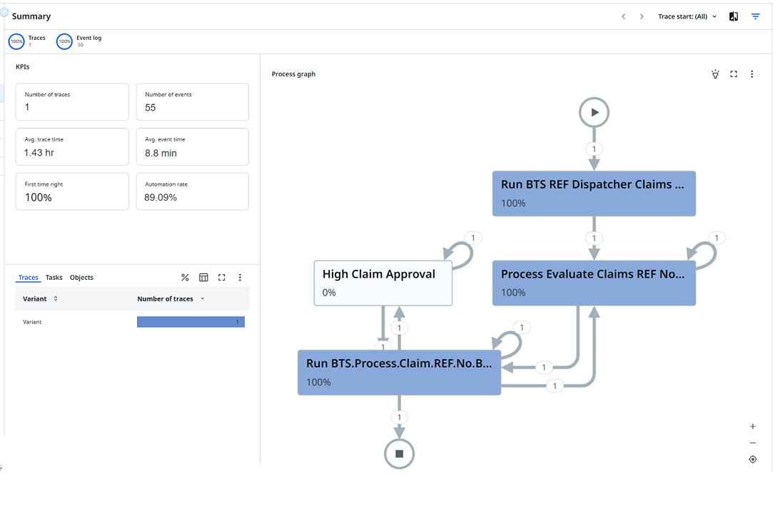

Implicit Process Tracking
Using implicit process tracking, each automation execution of an automation generates a trace and each automation is considered a task. This means that when an automation executes, a trace and a task are generated.
If two automation workflows have a linkage (via a QueueItem or via a Start Job and Get Reference activity), the trace ID is passed from one automation workflow to another to capture the causality.
Therefore, if the above Claim Processing automation is updated with the latest Robot and System package and runs for a while, the Process Optimization app generates the following process graph:
Implicit process tracking
The Archived Closed Claim automation does not appear in the process graph because it is not linked to the Process Claim through a UiPath component. Instead, it is connected via an external system. To establish this linkage, it is needed to implement Explicit Process Tracking.

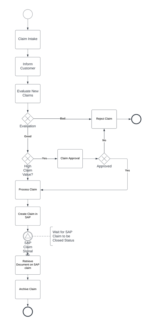

Explicit Process Tracking enables RPA developers to enhance the implicit Process graph by adding additional tracking data, making it more aligned with a BPMN view.
Explicit process tracking
Typically, each automation workflow consists of multiple tasks and processes various objects. The Process Owner must have end-to-end visibility of these flow paths, tasks, and objects. This clarity can significantly improve workflow management and efficiency.
Using explicit process tracking activities, the RPA Developer can track additional Task and Objects or manage Traces and Processes and track them spanning external systems.

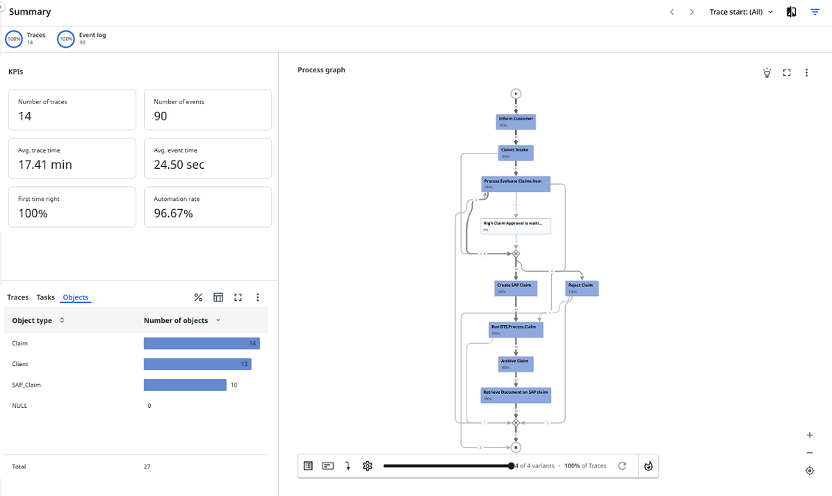

The following illustration displays the Claim Process with explicit tracking added.
Explicit process tracking in Process Mining

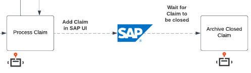

Propagate a Trace through external systems
There are scenarios where the process requires an automation to pass the Trace through external systems before returning to a second automation. The following illustration shows the Claim Processing example, where the Process Claim automation adds the Claim in SAP. After a certain period of time when the Claim reaches a specific Status a second automation takes the claim back and archive it together with all the documents.
Claims Processing example with SAP
The only connection between the two is the Object added to SAP. For the Archive Claim to associate a Task with the same Trace as the one used in Process Claim, the first automation must track the SAP Claim Object. Subsequently, the second automation must implement a Process Tracking Scope to add a Task to the existing Trace, identifying it based on the object details recorded during the previous automation. Additionally, ensure that both Automations are part of the same Process by using the same Process name in the second automation as that in which the first automation is included.Ensure that both Automations are part of the same Process by using the same Process name
note
The object identification details recorded in the first process must match the details entered in the external system to avoid duplicating fields. If the object details are the same, you can use Process Mining to incorporate additional external systems into the same Process Optimization app.
