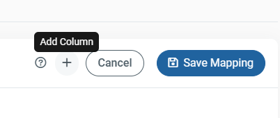

  3. Go to Columns and select Edit Mapping.
  4. Select + (Add Column).
    Add column option in CData Sync task
