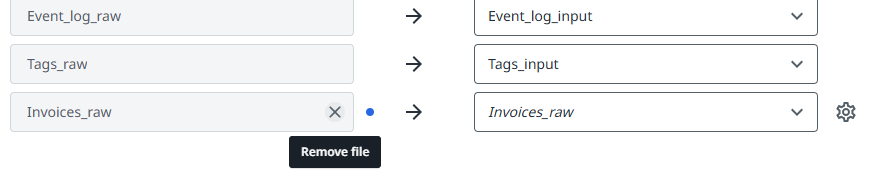

  1. Locate the source file you want to remove in the Source tables list.
  2. Hover your mouse over the table, and select Remove file.
The input file is removed.
