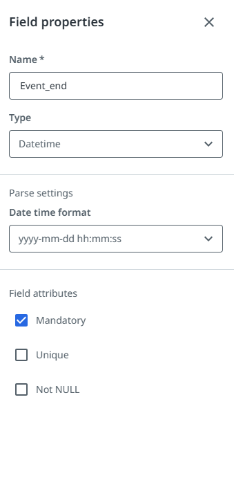

  1. Set the data type and renames using the Manage input data settings option in Data transformations.
  2. Check the Field attributes (Mandatory, Unique, not NULL) in the Field properties panel and make sure they are set correctly.

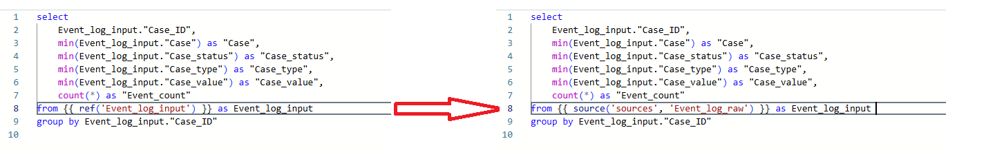

Field properties 3. Check all the SQL files for references to the input table: {{ ref('table_name') }}, and update these references to use the new table:
Replace every occurence of {{ ref('table_name') }} with {{ source('sources', 'source_table_name') }}. For example: replace {{ ref('Event_log_input') }} which pointed to your SQL files with {{ source('sources', 'Event_log_raw') }} to point directly at the source table.
Replace table references
note
These references can occur in any SQL file.
