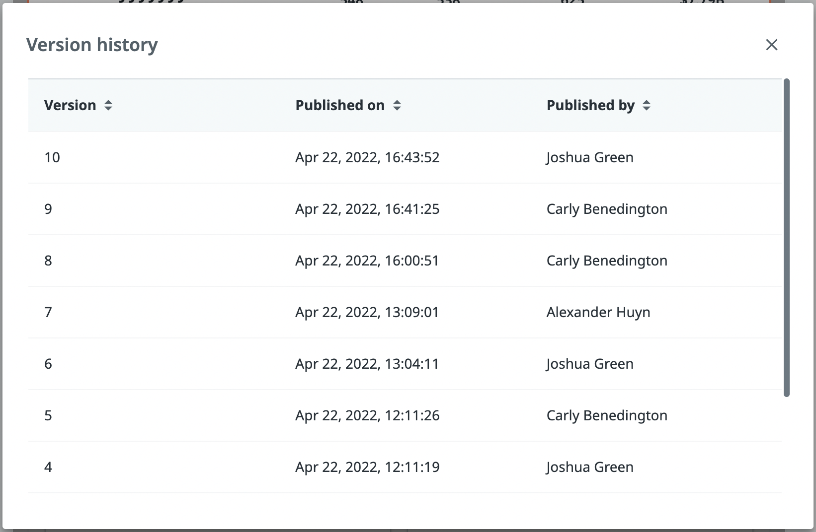

Viewing the publishing history
To view the publishing history of a process app, select Version history at the top of the dashboard editor.
A popup window is displayed with a list of all created versions. For each version, the publishing date, and the name of the developer who published the version is displayed.
Version history
tip
You can also view the publishing history from the Published process apps in the Process Mining portal.
  1. Select on the app card of the app for which you want to view the publishing history and select Version history from the context menu.
