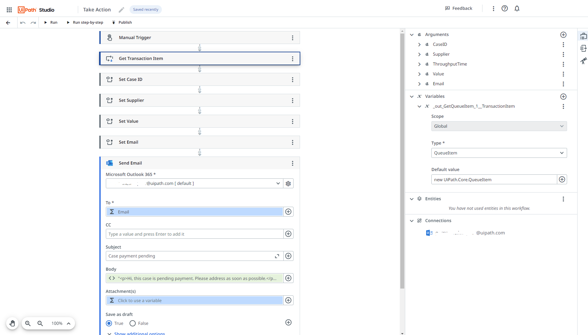

To set up Automation integration, first create an automation workflow in Studio. For example, you can set up an automation for sending an email when an item is added to an Orchestrator queue. This automation can be used, for example, to send a reminder email for a late payment case detected in Process Mining. The following illustration shows an example automation workflow.
Example automation workflow
Define a Get Transaction Item activity in the automation workflow if you want to enable pulling items from queues.
In the above example: Set Variable Value activities are used to set the arguments to variables that can be used in the email. The Microsoft Office 365: Send Email activity is used to send a notification email from the automation.

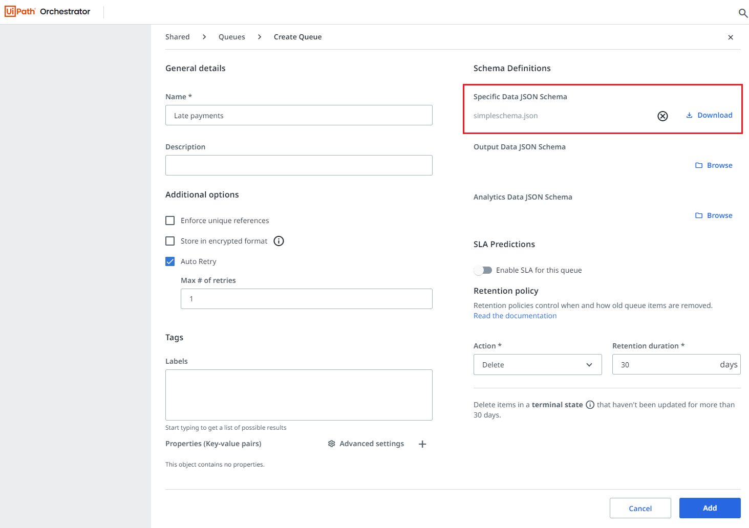

  1. In Orchestrator, create a new queue using a Specific Data JSON Schema. The Data JSON Schema defines the input data that is required for the automation. Make sure the JSON schema matches the arguments defined in the automation.
    important
    Only queues containing a Specific Data JSON Schema file in Orchestrator are supported by Process Mining. The following code shows an example of a Specific Data JSON Schema that is used to set up integration with Process Mining.

Specify data JSON schema

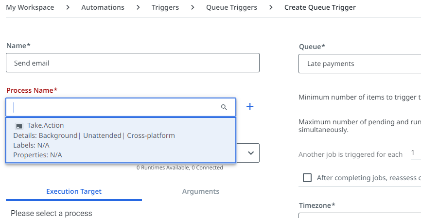

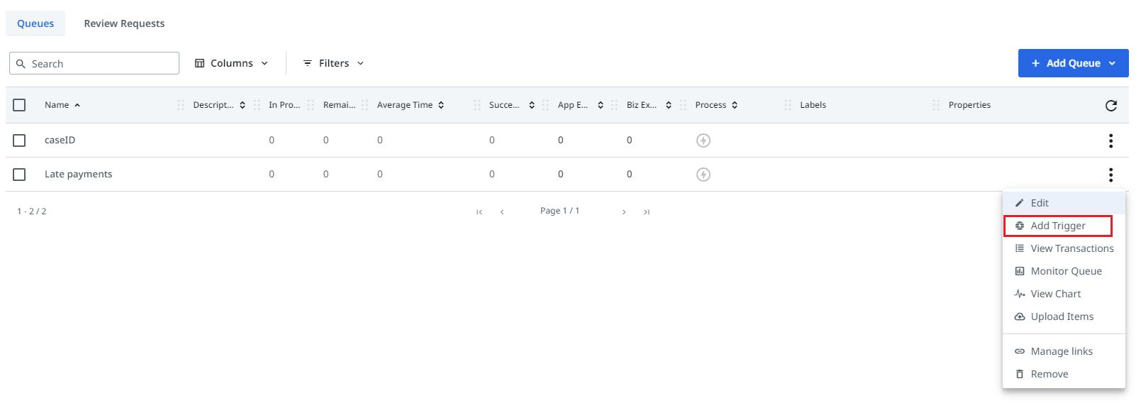

  1. Add a Trigger for the queue and select the automation workflow you created in Studio as the process associated.
    Add trigger Select automation workflow

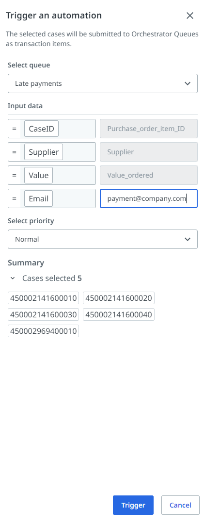

When the user has selected objects that are candidate for automation, the Trigger an automation option can be selected to enter the input data for the automation.The following illustration shows an example.
Trigger an automation panel

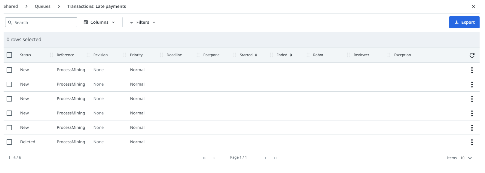

For every case that is selected, a Queue item is created in the Orchestrator queue that will trigger the automation defined in Studio.
Queue items in the Orchestrator queue
