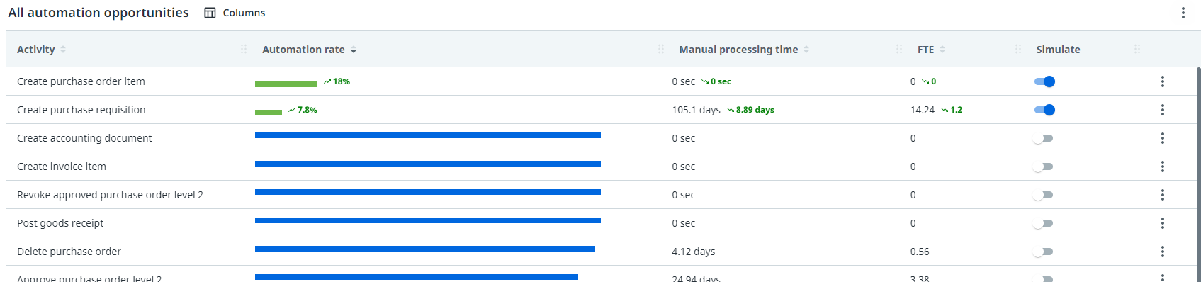

All automation opportunities
The All automation opportunities chart displays the activities based on the current Automation rate, which is determined by the percentage of events that are automated. The activities with the lowest automation rate are displayed first.
The following table contains a description of the elements.
ElementDescription
ActivityThe name of the activity.
Automation rateThe percentage of events that are automated.
Manual processing timeThe total amount of time that is actually spent working on the events.
Manual processing costThe total costs spent on the events. Note: Manual processing cost is only displayed if the event_cost field is available in your dataset.
FTEThe total time that is needed to perform the work for events. FTE is calculated by dividing the manual processing time in hours by the number of working hours. The number of working hours is calculated from the number of working days in the selected period * 8 working hours per day.
SimulateA toggle button that displays the results of the simulation. If you have not performed a simulation for the action, the Modify simulation panel is displayed, where you can enter different values to use for calculating the automation potential.

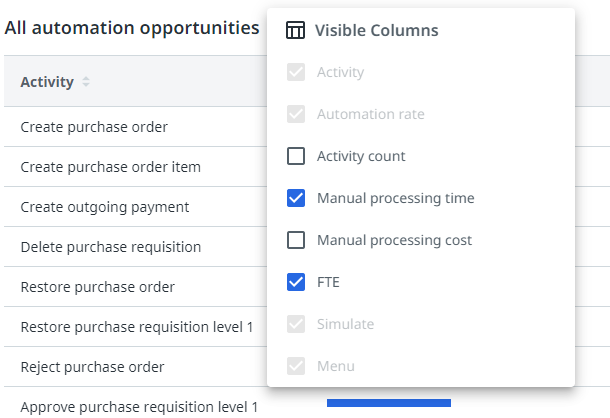

Selecting visible columns
Follow these steps to change the visible columns.
  1. Select the Columns icon Columns icon to display the list of columns.
  2. Select the columns you want to display in the selected All automation opportunities chart.
    note
    The Activity, Automation rate, Simulate, and Menu columns cannot be hidden.
