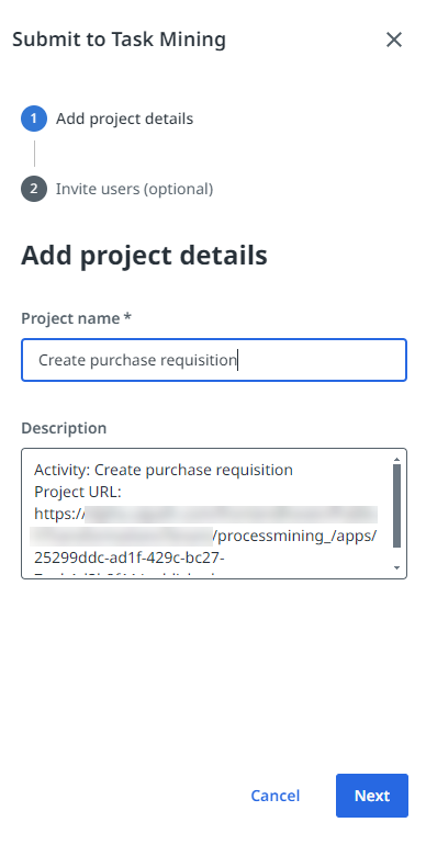

The Submit to Task Mining wizard is displayed to the right. Submit to Task Mining wizard
  1. Enter a name for the Task Mining project in the Project name field.
  2. If desired, change the Description. By default, the name of the selected activity and the link to the Task Mining project that will be created are displayed in the Description field.
  3. Select Next to go to the Invite users step.
  4. Add recording users by typing the username, group name, or email and select the desired result from the dropdown list.
note
Users will receive an email invitation to the project and a link to download the Task Mining recorder.
  1. Select Create to create the Task Mining project and to start the recording. You can select the Task Mining project link to view the Task Mining project and to analyze the results.

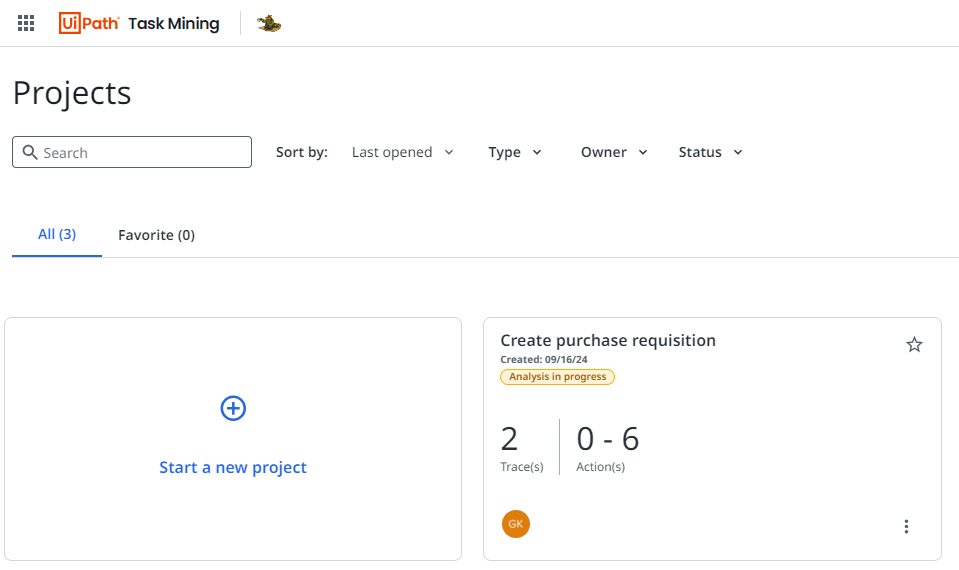

  1. In the process graph, select Task Mining -> View Projects from the menu. The Task Mining projects panel is displayed, showing the Task Mining project cards for the projects created from the process app.
  2. Locate the project card for the Task Mining project you want to view and select View data.

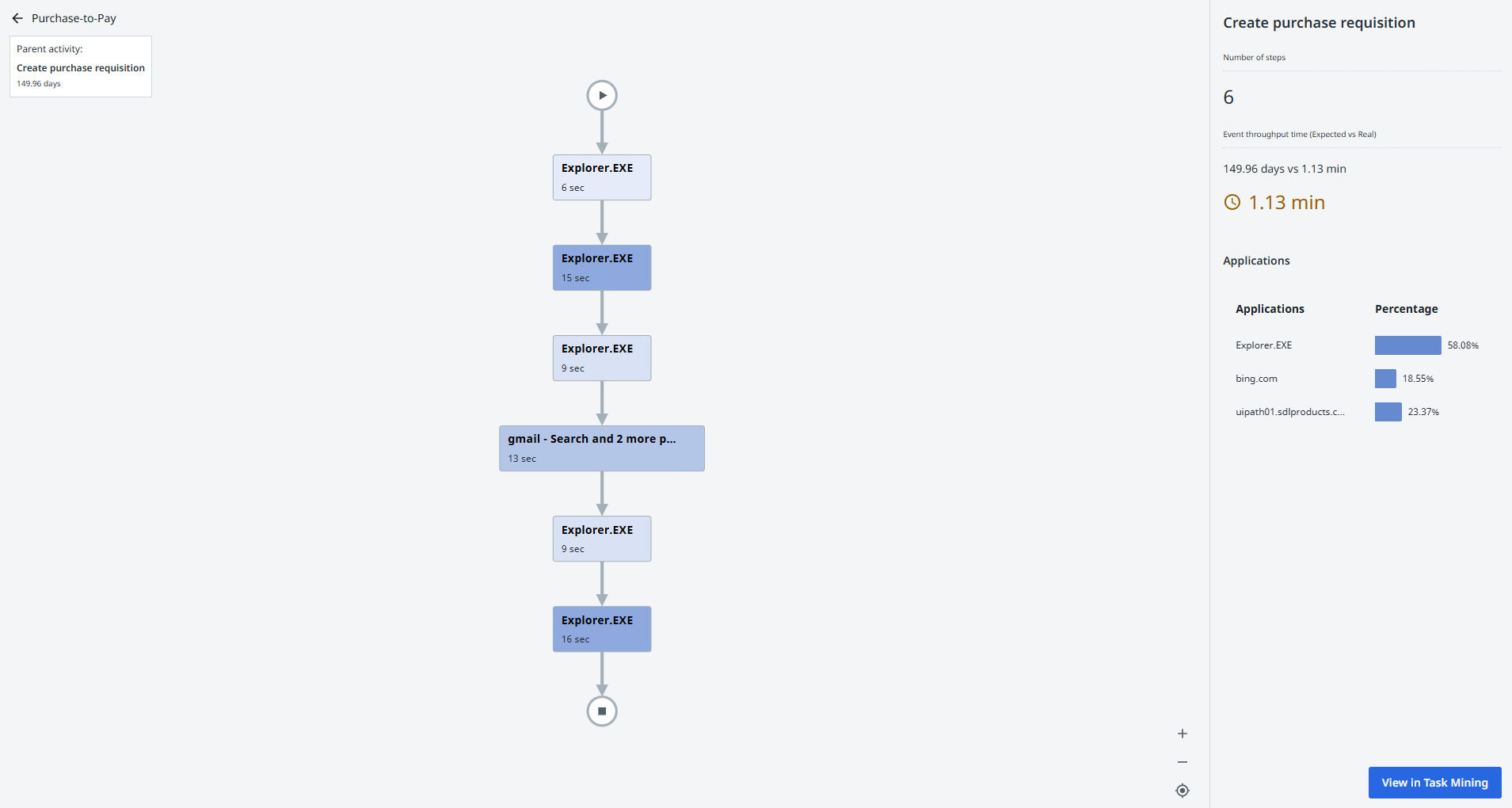

The Task Mining trace diagram for the project is shown alongside key KPIs, which provide trace details such as application usage, number of steps, and comparisons between waiting and cycle time.
note
The trace diagram displays the trace that is marked as the Ideal trace in the Task Mining project. The Ideal trace is the Task Mining trace that is representative of the applicable Process Mining activity scenario. Refer to Trace details in the Task Mining guide for more information on the ideal trace.
Task Mining trace
The Task Mining trace displays the sequence of steps taken to complete the particular activity. Each step in the trace includes the title or description of the step, its duration, waiting time, and the application that was used. This provides a detailed view of the activity, that can be used to analyze and optimize the performance of the activity.
Task Mining trace in Process Mining
Trace details
The Trace details panel provides more detailed information about the activity trace.
The following table describes the KPIs.
MetricDescription
Number of stepsThe total number of steps in the trace.
Event throughput time (expected vs real)The total execution time of the activity.
Note: The actual amount of time it took to execute the activity, including waiting time, is displayed in red.
Waiting timeThe total waiting time for the activity.
ApplicationsThe applications/domains recorded in the trace.
Note: For each application/domain the percentage of total event throughput time is displayed.
