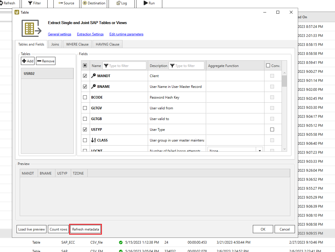

You may encounter unexpected errors during extraction. For example:
23,O2C_VBAK,2023-05-16_08:46:54.984,4,FinishedErrors,Error,LiveDataExtraction,Theobald.Extractors.Table.TheoReadTableException: Length of the field VBTYP not valid. Given length is 000002 . Length in SAP is 000008
This may be caused by the fact that the properties defined in the template extractions do not match with your SAP system.
In Theobald Xtract Universal, select the Refresh metadata button to update the metadata properties to reflect your SAP system and check if the issue is solved.
Refresh metadata
