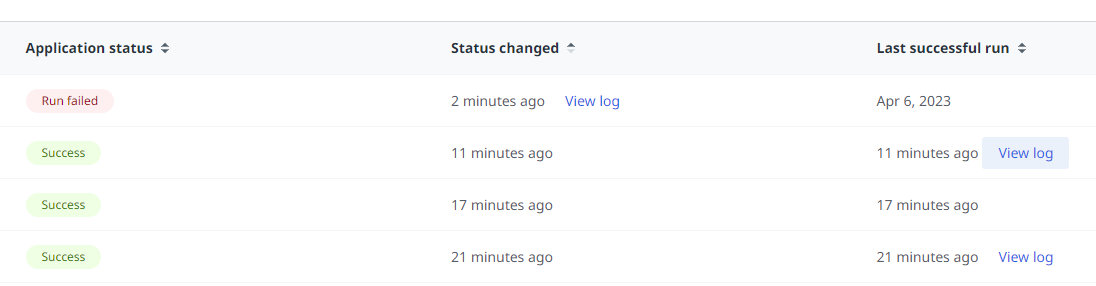

For every data run, a log is created with information about the extraction, loading, and transformation of the data. You can select the View log option to find out more details on the latest data run for your process apps.
View log option
