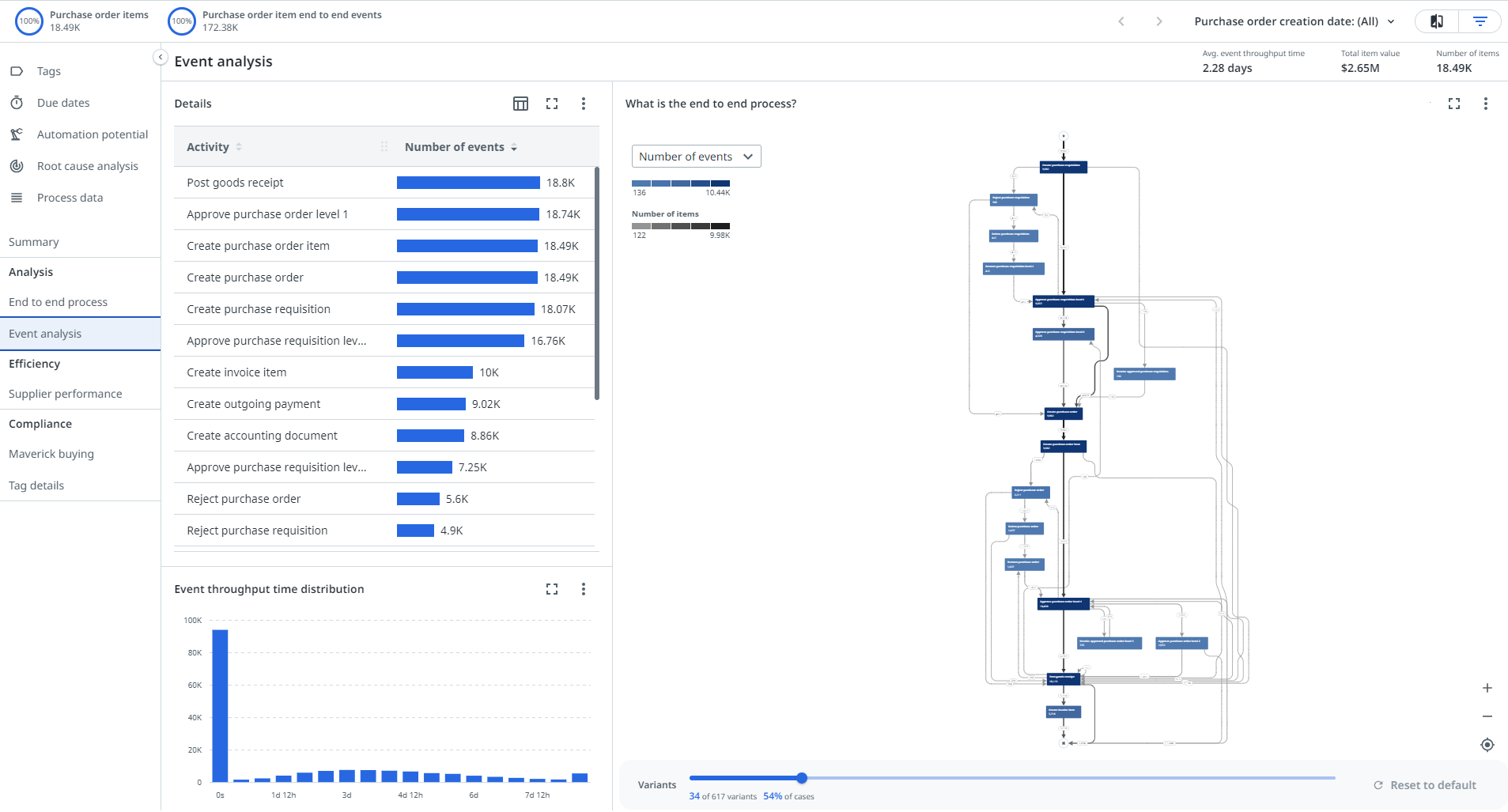

Example dashboard
Charts can have different layouts so that various aspects of the process can be shown.
On the left side, two tabs are available that each contain different charts. In the above example, the Details tab and the Trend tab. The right side contains one chart, the process graph.

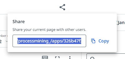

Sharing a dashboard
You can share the URL of the dashboard with others using the Share option. You share your current dashboard view.
note
If the recipient does not have the same app permissions, they might have a different result.
Follow these steps to share your dashboard URL.
  1. Go to the dashboard that you want to share.
  2. Optionally add filters if you want to create context.
  3. Select the Share icon in the header bar of the process app.
A pop-up window is displayed, showing the URL of the current dashboard.
Share dashboard 4. Select Copy to copy the URL to the Clipboard. 5. Send the link to the person you would like to share it with.
note
The URL captures the full-screen state. This enables you to share a link to a chart in full-screen mode. The URL also captures compare filters. This enables you to share the link to a compare view.
