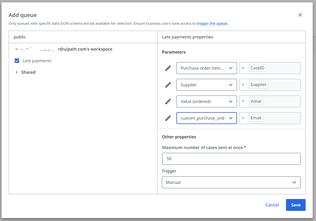

  1. In Automation manager, select + Connect automation. The Add queue page is displayed, showing all Orchestrator queues that have Specific data JSON schema. Refer toSetting up Automation integration.
  2. Select the queue you want to use for the automation. The required input fields for the queue are displayed in the Properties panel.
    Add queue dialog
  3. Select the type of trigger for the automation from the Trigger list box.
  4. Map the queue input fields to the appropriate data fields of your process app.

Instead of mapping to a specific data field, you can select the Busines user input option for a text input field. This enables business users to enter a free text when triggering an automation.
note
The Business user input option is only applicable to Manual triggers.
  1. Enter the Maximum number of cases sent at once to limit the number of cases that can be sent to Orchestrator.
    note
    As an analyst, it is important to consider limiting the number of cases a business user can send to Orchestrator based on the specific use case. By default, the system allows 50 cases to be sent to the queue, but the range can be adjusted from 1 to 1000, providing flexibility for different scenarios.
    Add queue
  2. Select the type of the trigger for the automation from the Trigger list box.
    • If you want to configure an Automatic trigger for an automation, add the fields and select the field values to define one or more trigger conditions.
      note
      Only field of type nominal can be used for trigger conditions.
A case that meets a condition when the filter is evaluated will be sent to Orchestrator. :::note Each trigger condition is evaluated separately. For example, Case 001 has tags A and B. When you have set the trigger conditions for both A and B, this case will be sent to Orchestrator twice (one based on condition A, and one based on condition B). ::: 7. Select Save.
