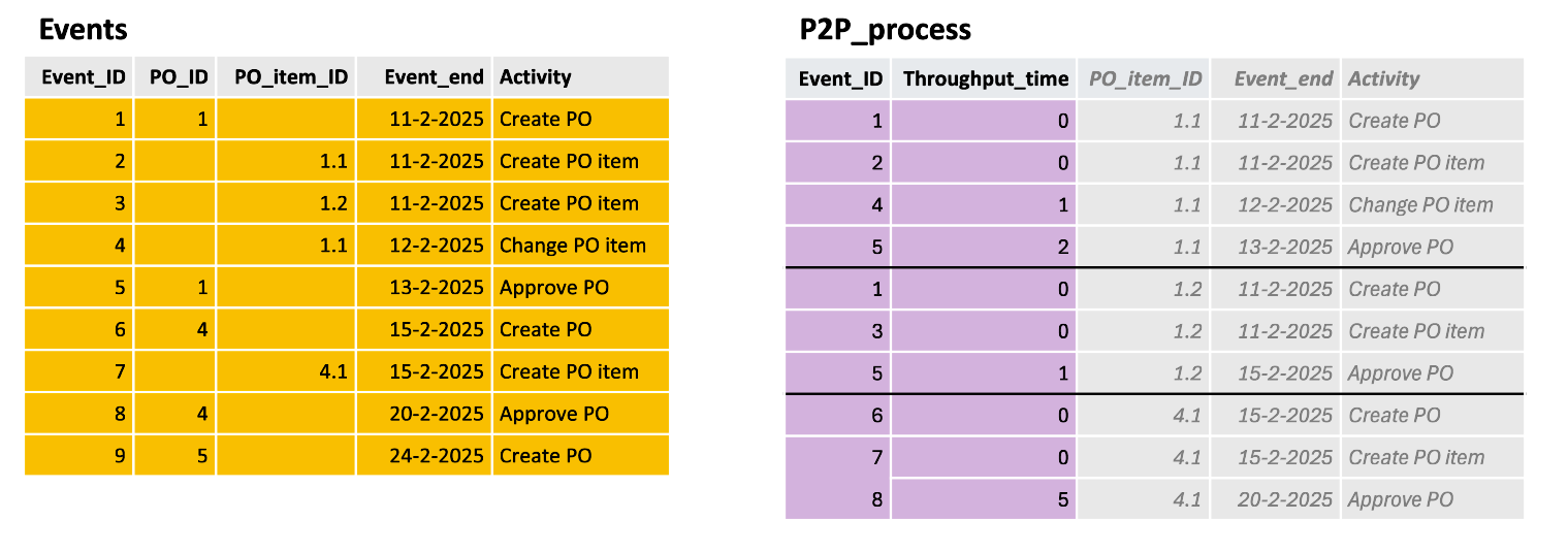

Each process defined in your data model has its own Process table with the projected events for that process. The following fields are always present in the event tables:
  • Process_event_ID, unique ID for each record in the process table.
  • Event_ID, unique for each individual event, regardless of in which process it's used. In the example below, event_ID 1 occurs twice in the process table.
  • Throughput_time, time from previous Event_end to the current Event_end.
  • Cycle_time*, time from Event_start to Event_end.
  • Cycle_time is only available if the events have an Event_start defined.
The following illustration shows an example Process table containing the events for the P2P_process.
Process table for the P2P process
