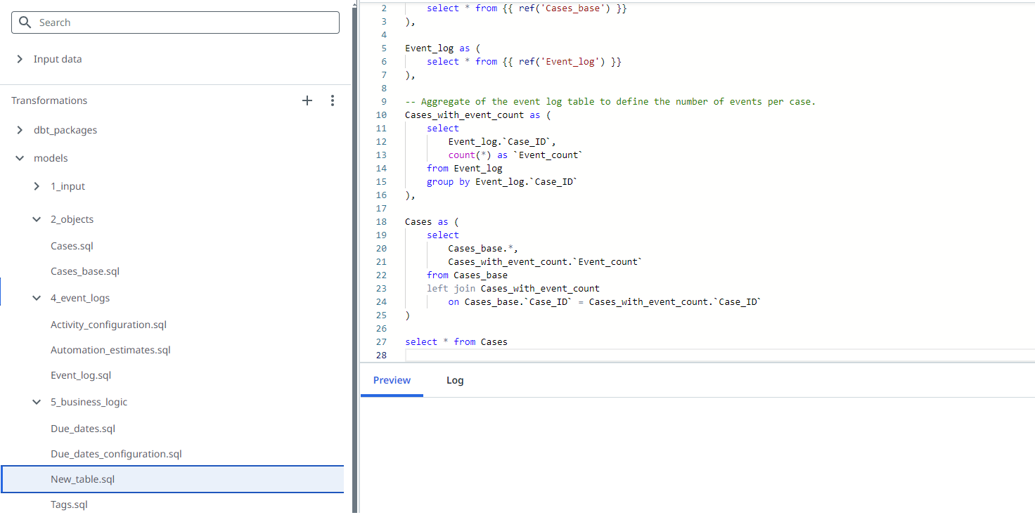

  1. Go to the Data transformations editor.
  2. Locate the models section and add a new .sql file for the table in the transformations that you want to expose to your process app.
    Adding a table
  3. Run the query for the new file. You can check the data for the new table in the Preview panel.

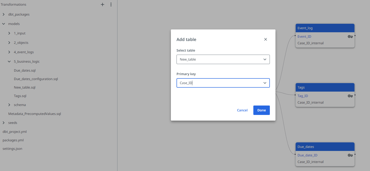

  4. Select Data model to view the data model for your process app.
  5. Select + Add table. The Add table dialog is displayed.
  6. Select the table that you added in step 2 from the Select table list.
  7. Select the Primary key for the new table, and select Done.
    Add table dialog

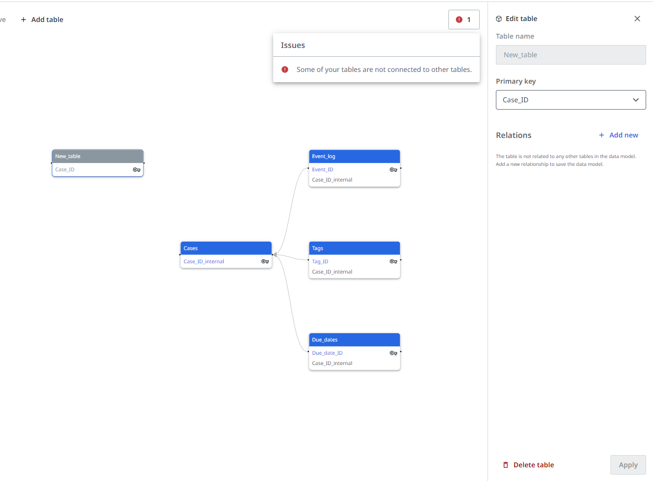

The Edit table panel is displayed.
A notification is displayed that your data model does not meet the requirements.
Edit table panel

  1. In the Edit table panel, select + Add new to create a new relation.
  2. Select the field that is used a the Primary key to join the tables.
  3. Select the Foreign key and select Apply.

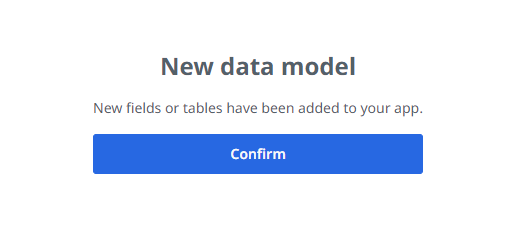

  3. Select Edit dashboards and open the Data Manager. A message is displayed indicating that the new table is added.
    New data model conformation message
  4. Select Confirm to continue.
