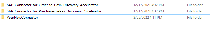

Adding the Connector
Follow these steps to add a custom .mvp connector to DataBridgeAgent.
- Go to the
workspaces/Connectordirectory. - Create a new directory for the new connector.
note
The name you give this directory will be the value you have to fill in for connectorWorkspace.
See the illustration below.
3. Copy the .mvp connector file in the new directory.
4. Edit the datarun.json, and fill in the connectorWorkspace and the connectorModule that correspond to the mvp connector. See the illustration below.
