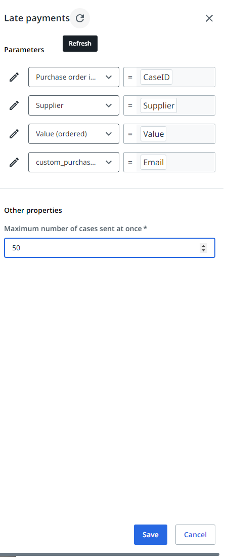

Refreshing the queue
important
If any changes are made to the Orchestrator queue, you need to refresh the queue in Process Mining. For example, when the Specific data JSON schema has changed, or when the name or description of the queue was edited in Orchestrator. To refresh the queue in Process Mining, you edit the automation in Automation manager.
Follow these steps to refresh the queue for an automation.
  1. Locate the automation for which you want to refresh the queue and select Edit settings icon.
  2. Select the Refresh button at the top of the properties panel. See the illustration below.
    docs image
  3. Select Save.
