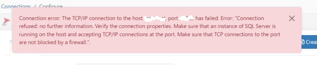

Connection error: The TCP/IP connection to the host <host>, port <port> has failed.
The following message is displayed when setting up a SQL Server destination connection in CData Sync.
Possible cause
There is an issue with CData Sync connecting to SQL Server.
Solution
Open SQL Server Configuration Manager.
Check the TCP Port number.
Check if TCP/IP is set to Enabled for the Port. The following illustrations shows an example.
