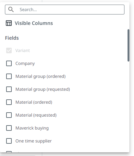

Switching display fields
To enable end-users to select a different view for the chart, you can select different fields that will be added to the selector. The following illustration shows an example of a field selector.
Visible columns

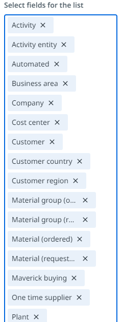

When you select the fields, a list of all fields available in your process is displayed.
Select fields list
