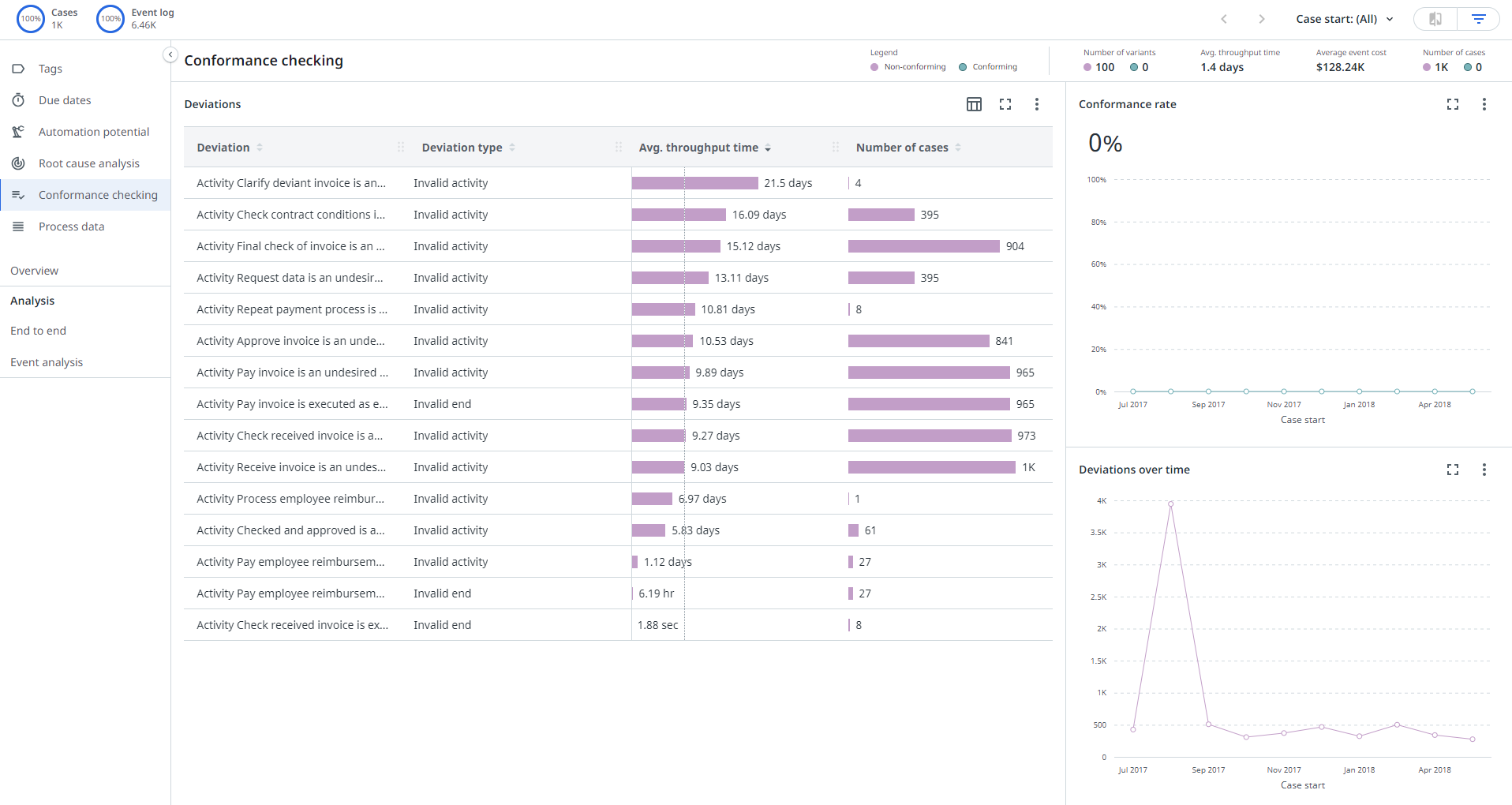

Displaying the Conformance checking dashboard
Follow this step to display the Conformance checking dashboard.
- Select Conformance checking in the menu on the left of the dashboard.
The Conformance checking dashboard is displayed.

Dashboard charts
See the following overview of the available charts on the Conformance checking dashboard.
| Chart |
Description |
| Deviations | A bar chart showing the detected deviations, deviation types, and the number of cases where every deviation appears. |
| Conformance rate |
A line chart showing the conformance rate over time. Note: Conformance rate is the percentage of cases that conform to the reference model. A higher conformance rate means there is a greater degree of conformance to the reference model. |
| Deviations over time |
A line chart showing the total number of deviations over time. |
