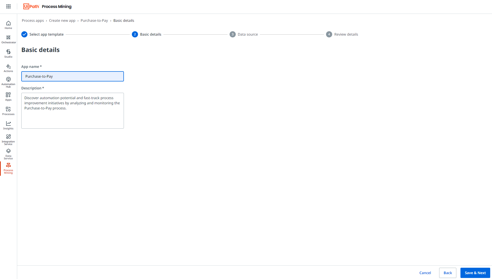

Defining the app properties
  1. Edit the name to define a unique name for the new process app in the App name field.
    note
    If an app with the name you enter already exists for your tenant a message is displayed, and the Save & Next button is disabled.
  2. If desired, edit the description in the Description field.
  3. Select Save & Next.

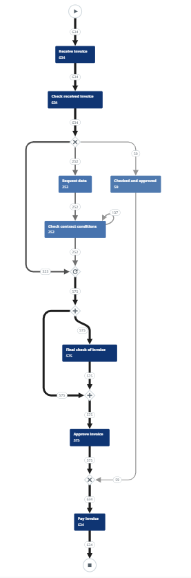

Discover process model
Discovering a process model allows you to have a better understanding of your process structure. By analyzing the whole process (the whole event log) with advanced process mining techniques, activities that happen in parallel, are part of a decision, or are part of a more complex loop are automatically discovered. These relationships are called the process semantics.
The following table describes the process semantic types used in discover process models.
Semantic node typeDescriptionVisual representation
Parallel gateway (AND)Represents two or more branches that happen in parallel.Parallel gateway (AND)
Exclusive choice gateway (XOR)Represents an exclusive choice (decision point) between two or more branches.Exclusive choice gateway (XOR)
Loop gatewayRepresents a repeatable sub-process with one loop body path and one or more rework paths.Loop gateway
Example Discover model process graph

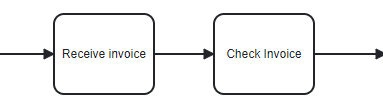

RequirementExample
A start event must be defined, and there can only be one start event.docs image
An end event must be defined, and there can only be one end event.docs image
At least one activity task must be defined.docs image
There must be at least two sequence flows defined for the BMPM model.docs image
The tasks must have unique labels.docs image
