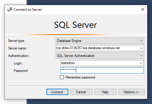

  • create a new database schema for the process app. You can do this in Microsoft SQL Server Management Studio. Follow these steps.
    StepAction
    1In the Object Explorer in Microsoft SQL Server Management Studio, go the folder of your database in the Databases folder.
    2Right-click on Security and select New -> Schema...
The following illustrations shows the SQL Server authentication window.
docs image
Refer to the official Microsoft documentation for more information.

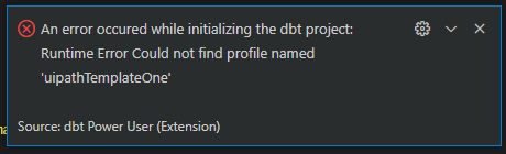

When you open a dbt project in Visual Studio Code for the first time, a dbt message is displayed, indicating that the profile corresponding to your new transformations cannot be found. The following illustration shows an example.
Example error message

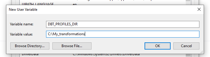

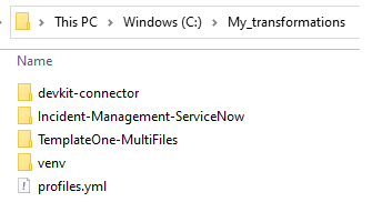

4Save the profiles.yml file in the folder that does not contain a dbt project For example, C:\My_transformations.
5Create an environment variable called DBT_PROFILES_DIR with the file path of the folder that contains the profiles.yml file.
My_transformations folder
