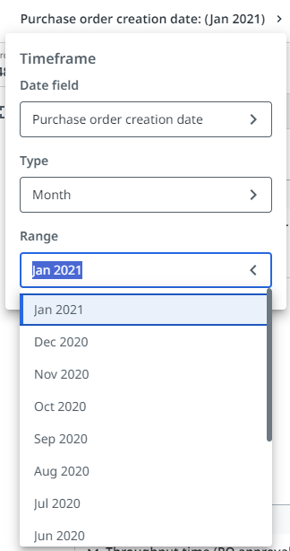

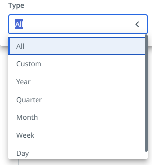

Timeframe filter
The Timeframe filter is a predefined and immovable filter. This Timeframe filter splits the data according to the selected date field of relevant items in the dashboard. For example, purchase order items or purchase order events for purchase orders created in the selected timeframe.
The Date field list contains all the fields of type datetime that are defined for your dataset. Depending on the dashboard context, the selected Date field will return relevant results.
When you set the Timeframe filter Type to Week and choose a week number from the Range list, the selected week is counted from Sunday to Saturday.

Defining a custom timeframe
You can select a custom timeframe to be used as the timeframe filter. All relevant items that have a date according to the selected date field within the defined timeframe are displayed in the dashboard.
Follow these steps to select a custom timeframe.
Select the Timeframe filter button.
Select the Date field you want to use for the timeframe.
Select the Type list box and select the Custom option from the list.
Select the From field and select the start date of the custom period you want to define from the date picker.
Select the To field and select the end date of the custom period you want to define from the date picker.

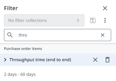

Searching applied filters
To easily find a particular filter, you can search for applied filters.
Follow these steps to search for applied filters.
Go to the Filter panel.
Select the
icon to open the Search... field. -
Start typing the filter you want to find in the Search... field.

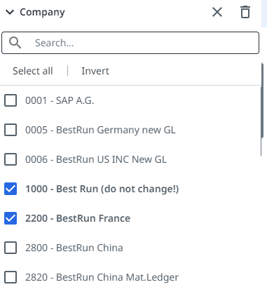

List box
A list box filter allows you to select multiple values of a field.
Select all / Deselect all
You can select the Select all option to select all the options from the list box in one click.
Invert
You can click on Invert to change all unselected values into selected values, whereas all selected values will become unselected.

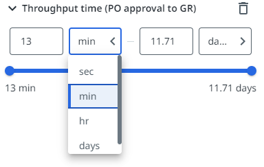

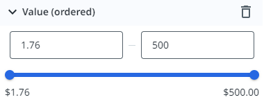

Range selector
A range selector is created for numeric fields and time ranges. This filter allows for a range to be selected. You can either drag the dots on the line to select a range, or enter the desired start and end values in the value fields.
The following illustration shows an example.
For time ranges you can change the granularity of the selected range by selecting a different units from the drop-down lists. The following illustration shows an example.

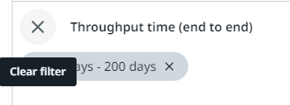

Resetting Individual Filters
Follow these steps to reset the values of an individual filter.
Go to the Filters panel and locate the filter for which you want to reset the values.
Click on
Clear filter.
