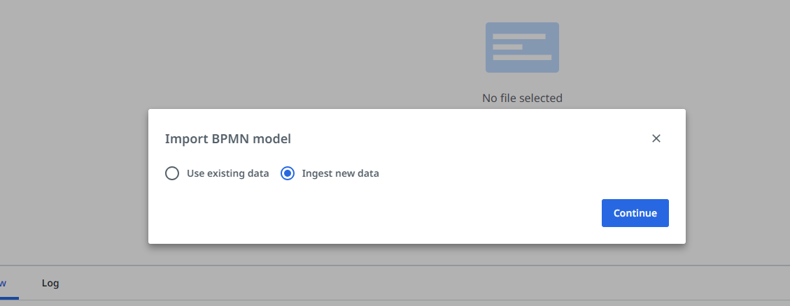

  3. Select Upload BPMN file to start importing the BPMN model. When the file is successfully imported, the Continue button will be enabled.
  4. Select whether you want to use exisiting data or to ingest new data for the process app.
    docs image
  5. Select Continue to upload data and/or finish the import of the BPMN model.
