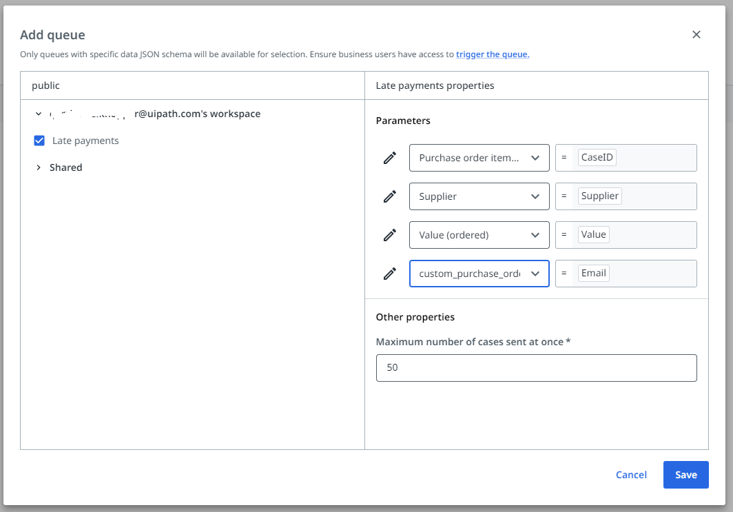

  3. Add a new automation and select the Orchestrator queue.
    • Click on +Add automation.
    • In the Add queue dialog select the Orchestrator queue you want to use. The data schema defined in the Data JSON Schema file for the Orchestrator queue is loaded. Note that only queues containing a Specific Data JSON Schema file in Orchestrator are available for Process Mining.
    • Map the automation input fields to the appropriate data fields available in your process app.
    • Enter the Maximum number of cases sent at once to limit the number of cases that can be sent to Orchestrator.
      note
      As an analyst, it is important to consider limiting the number of cases a business user can send to Orchestrator based on the specific use case. By default, the system allows 50 cases to be sent to the queue, but the range can be adjusted from 1 to 100, providing flexibility for different scenarios.

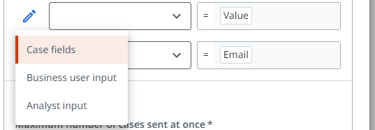

    Check out the data type of the queue input fields defined in the Specific data JSON schema and make sure to map the input fields to a Process Mining data field with the correct input type. See App Templates. :::Instead of mapping to a specific Case field, you can select the Business user input option for a text input field. This enables business users to enter a free text when triggering an automation. For example a description or an email address. The Analyst input option enables you to enter a custom text which is displayed as read-only to the business user.
