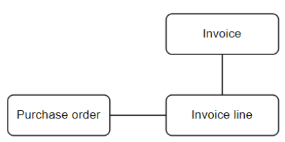

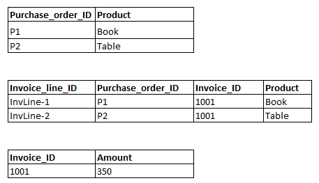

In the following example, there are three objects: Purchase order,Invoice line, and Invoice. The Purchase order is considered the main object in the process. The Invoice line is directly linked to the Purchase order and the Invoice is linked indirectly via the Invoice line.
Example objects
Example object tables
