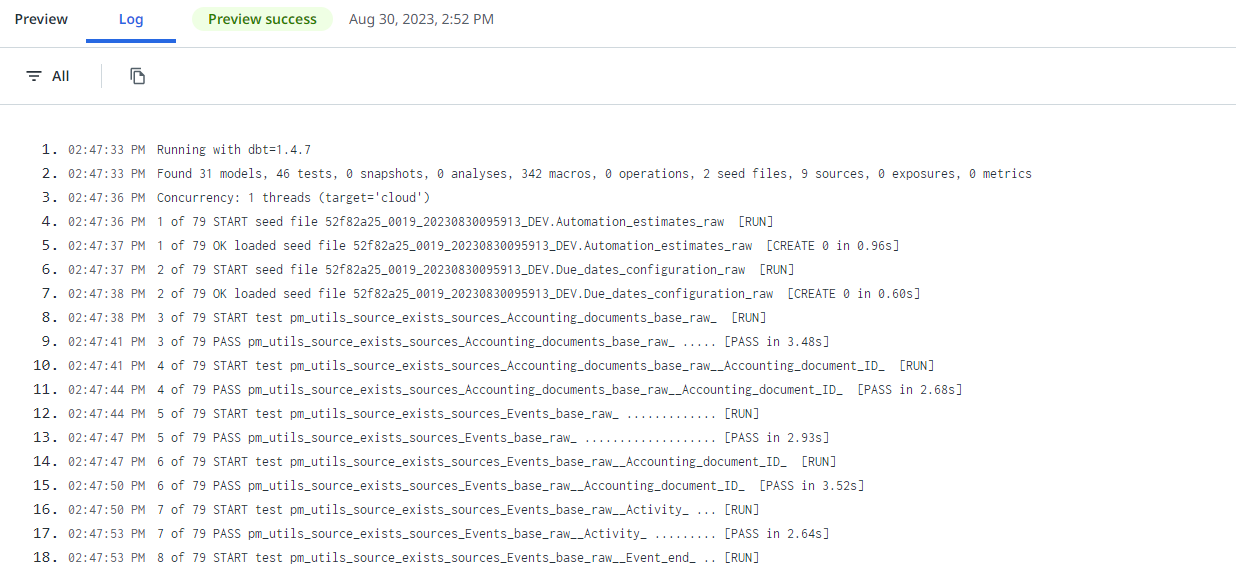

The Log panel shows what happens in the background. The Log panel is refreshed automatically every couple of seconds. The following illustration shows an example log.
Transformations log example
