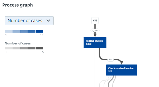

The process graph consists of the activities of your workflow and edges which represent the transitions in between the activities. The following illustration shows an example.
Process graph
The activities vary in color. Also, there is a difference in the thickness of several edges. In the process graph, both these colors and the thickness of the edges, indicate the number of objects going through the activities/edges.
Also, the number of objects going through this process is shown on the edges.
The legend at the top left shows the metric used in the process graph. Beneath the legend the minimum and maximum numbers are displayed. The legend colors correspond to the colors of the Activities and Edges (transitions) in the process graph.

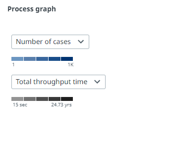

Viewing the process based on a different metric
A process graph can contain metric selectors for activities and edges. See the illustration below.
docs image
Follow these steps to select a different metric for the process graph.
StepAction
1Click on the metric selector in the process graph.
2Select a different metric from the list of available metrics.
The value for the selected metric is displayed on the activities in the process graph. See the illustration below, where the number of cases is displayed for the activity.
docs image

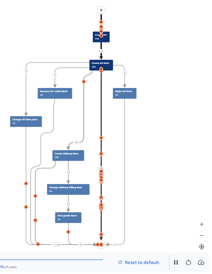

Process animations
With the Start animation button on a process graph you can start a visual animation to indicate how the cases are going through the process. This enables you to understand how the cases are flowing through the graph at a glance and spot how cases deviate from the happy path. For example, you can see where potential bottlenecks might happen, where the cases are spending the majority of time, and which cases require rework.
The Start animation button is a toggle button. Once you have started the animation, the button is labeled as Pause animation.
In the animation an indication is given how each of the cases, represented by a circle, go through the graph.
docs image
Viewing case details
When you paused the animation, you can select an animation ball to analyze the related case and on the lowest level by going to the Case details dashboard.
Restarting the animation
With the Restart animation button you can restart the animation at any time when the animation is running, and after the animation has finished running.
Setting a duration for the animation
With the Animation duration button, you can define the speed of the animation by specifying how long you want the animation to run. When you select a longer duration, the animation balls will move at a lower speed when playing the animation.

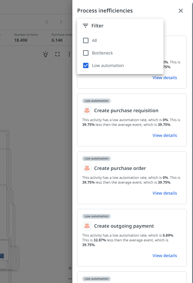

Identifying process inefficiencies
You can identify inefficiencies, such as low automations, directly from the process graph. This will help to to detect prossible issues in your process from the process graph.
Select the Process inefficiencies icon to open the Process inefficiencies panel displaying any process inefficiencies identified for your process.
note
Any filter aplied to the process graph is taken into account when process inefficencies are identified.
You can select the applicable process efficiencies from the Filter list, if you want to check particular types of process inefficiencies.
docs image
Below is an overview of the types of inefficiencies that can be identified.
Inefficiency
Description
Bottleneck
Activities that take double the average throughput time or activities that have highest throughput time.
Note:
The top 5 bottlenecks are displayed.
Manual processing
Activities that take double the average manual processing time or activities that have highest manual processing time.
Note: The event_start field must be present in your dataset to calculate Manual processing inefficiencies. The top 5 Manual processing inefficiencies are displayed.
Low automation
Activities that have an automation rate less than the average automation rate.
Rework
Activities that have multiple occurrences in a single case.
Viewing details on a process inefficiency
Select the View details option on a process inefficiency card to automatically apply a filter connected to the activity of the identified process inefficiency, which enables you to dive deeper into analysis of problem areas in your process.
