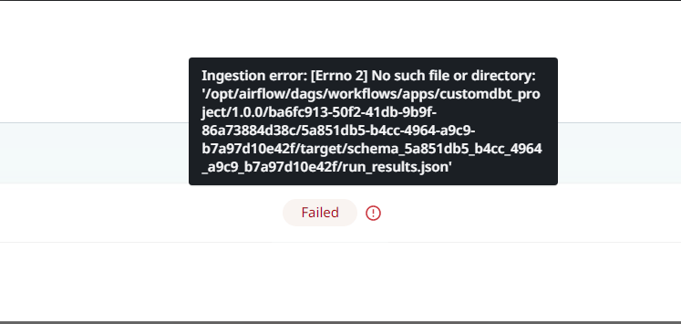

Message: [Errno 2] No such file or directory: '/dbt/dags/workflows/execdbt//target/4212eba4-1edc-4b9c-9c04-1d59c2bfe0af/run_results.json'
docs image
Possible cause
The content of the uploaded transformation package is incorrect, by an incorrect zip action.
Solution
Make sure the content of the .zip file that contains the transformations is correct.

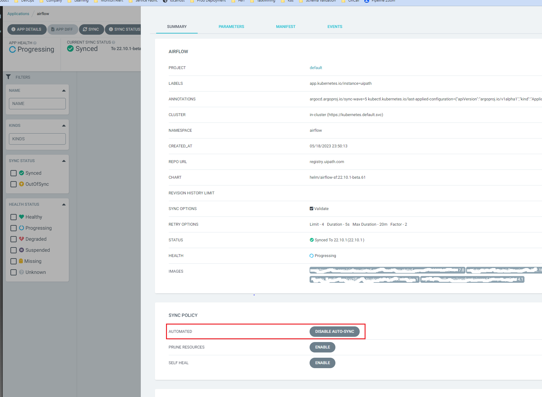

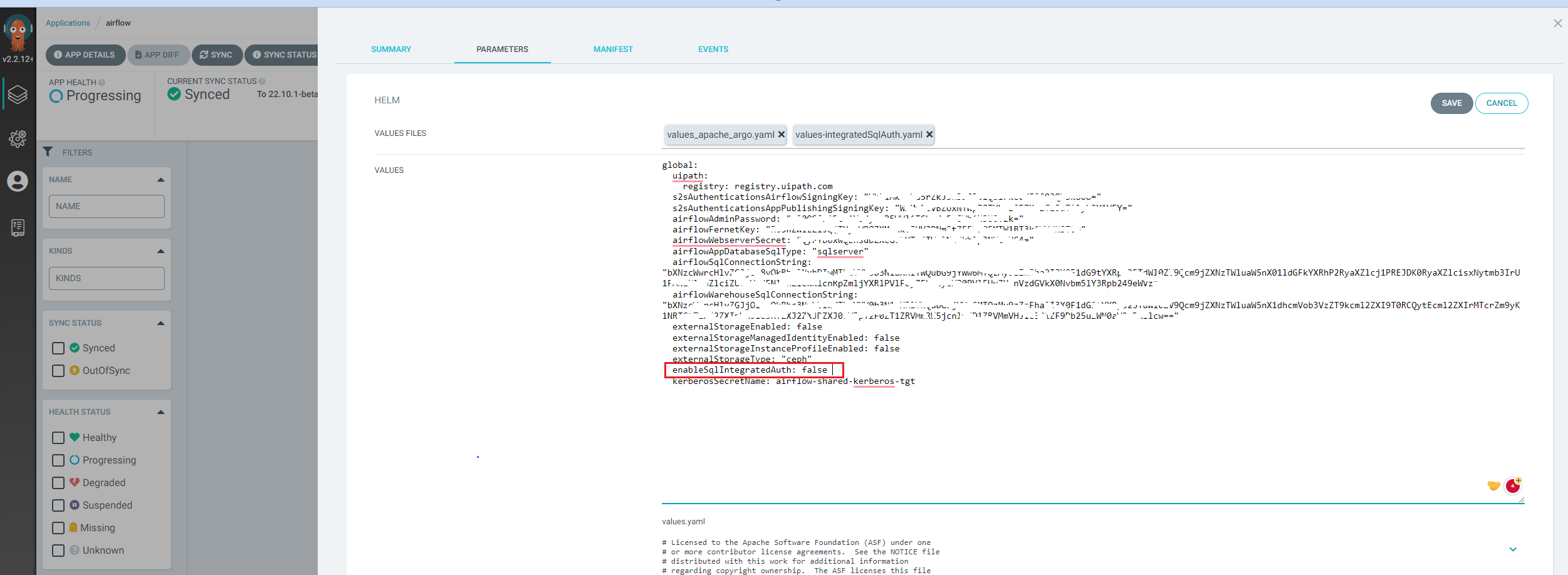

  1. In the ArgoCD Experience, enter Airflow in the search bar and open the card.
  2. Select App Details and go to the Details tab.
  3. Edit the VALUES and set the flag enableSqlIntegratedAuth to false. Select SAVE.
    docs image
  4. Locate the SYNC POLICY section and set AUTOMATED to DISABLE AUTO-SYNC for the Airflow app, to ensure the configuration flag enableSqlIntegratedAuth will not be brought back to true.

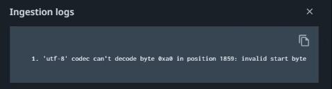

Message: utf-8 codec can't decode byte <byte> in position <position>: Invalid start byte
The following message is displayed in the data run log.
docs image
Possible cause
One or more input files you uploaded have an unexpected encoding.
Solution
Set the encoding to UTF-8 and set CR/LF end of line characters (Windows style).
You can change these settings in a file editor. For example in Notepad++.
  1. Open the datasource file in Notepad++.
  2. Go to Edit -> EOL Conversion and select Windows CR LF.
  3. Go to Encoding and select Convert to UTF-8.
  4. Save the file.

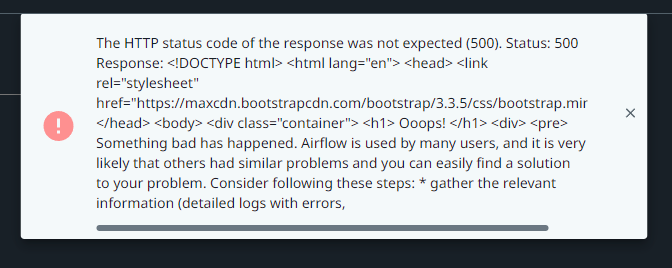

Message: The HTTP status code of the response was not expected (500)
When creating a new process app using sample data, the following error message can occur:
docs image
Possible cause
A SQL Server password has changed. Check out Configuring Microsoft SQL Server.
Solution
Update Automation Suite when changing SQL Server credentials.
