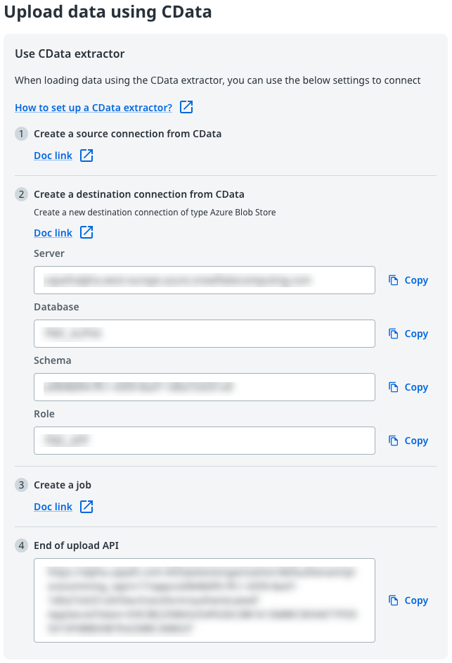

Upload data using CData Sync
If you have selected the Use CData extractor option in the Selecting the data source step, the Upload data using CData step is displayed.
Upload data using CData screen
  1. Copy the details for creating a destination connection from CDdata Sync and save them, for example, in a TXT file.
  2. Copy the End of upload API and save it, for example, in a TXT file.
  3. Select Finish.
  4. Follow the steps described in Loading data using CData Sync and use the above details to set up CData Sync.

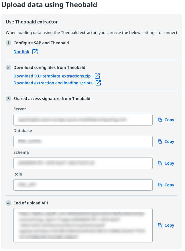

Upload data using Theobald Xtract Universal
If you have selected the Use Theobald extractor option in the Selecting the data source step, the Upload data using Theobald step is displayed.
Upload data using Theobald screen
  1. Download the configuration files from Theobald.
  2. Copy the details for the Shared access signature from Theobald and save them, for example, in a Notepad file.
  3. Copy the End of upload API and save it, for example, in a Notepad file.
  4. Select Finish.
  5. Follow the steps described in Loading data using Theobald Xtract Universal and use the above details to set up Theobald Xtract Universal.
