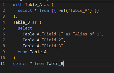

In some cases, for process apps created with earlier versions of the app templates, the .sql files have the following structure:
  1. With statements: One or more with statements to include the required sub tables.
  • {{ ref(‘My_table) }} refers to table defined by another .sql file.
  • {{ source(var("schema_sources"), 'My_table') }} refers to an input table.
  1. Main query: The query that defines the new table.
  2. Final query: Typically a query like Select * from table is used at the end. This makes it easy to make sub-selections while debugging.
    Example SQL query
For more tips on how to write transformations effectively, refer to Tips for writing SQL.

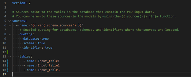

Adding source tables
To add a new source table to the dbt project, it must be listed in models\schema\sources.yml. This way, other models can refer to it by using {{ source(var("schema_sources"), 'My_table') }}. The following illustration shows an example.
Example sources.yml file
important
Each new source table must be listed in sources.yml.
For more detailed information, refer to the official dbt documentation on Sources.

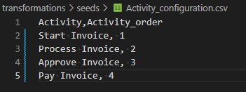

Option 2: CSV seeds file
Instead of using a SQL CASE statement, you can define Activity_order using the activity_configuration.csv file .
The following illustration shows an example activity_configuration.csv file:
Example activity_configuration.csv file
