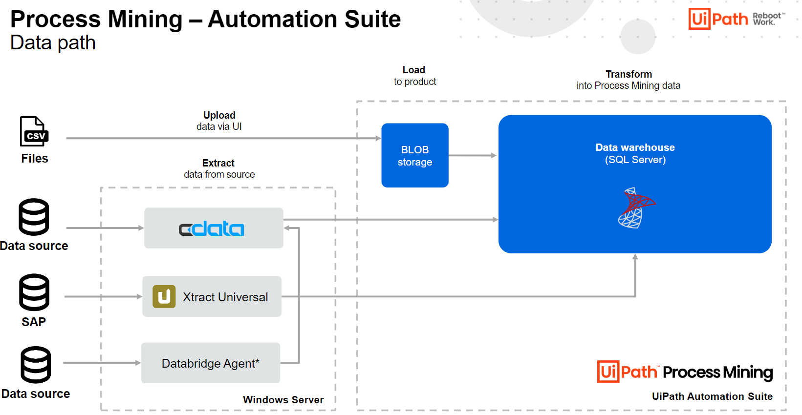

Depending on your source system, it is possible to run incremental data extraction with CData Sync.
Incremental extraction schema
