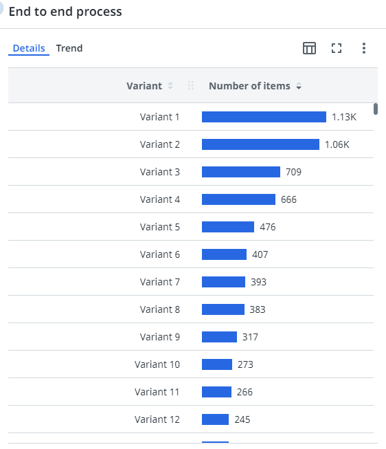

End to end process
With the End to end process chart you can analyze the purchase order items and throughput times in more detail. You can create various contexts by selecting different categories from the drop-down list. The metric selector enables you to select different metrics.
The metric of the selector determines the value displayed on the bar chart. The following table describes the metrics.
| Metric |
Description |
Base |
| Number of items |
The number of unique purchase order items. |
Purchase order items |
| Avg. item value |
The average purchase order item value for the selected category. |
| Total item value |
The sum of the purchase order item values for the selected category. |
| Avg. throughput time end to end |
The average throughput time for the end to end process, from creating a purchase requisition to the actual payment for the related invoice. |
| Avg. throughput time PR creation to PR approval |
The average throughput time from the creation of a purchase requisition to the approval of the purchase requisition. Note: The throughput time is calculated only if both dates are available and occurred in the right order. |
| Avg. throughput time PR creation to PO approval |
The average throughput time from the creation of a purchase requisition to the approval of the purchase order. Note: The throughput time is calculated only if both dates are available and occurred in the right order. |
| Avg. throughput time PR approval to PO item creation |
The average throughput time from the approval of a purchase requisition to the creation of the purchase order item. Note: The throughput time is calculated only if both dates are available and occurred in the right order. |
| Avg. throughput time PR approval to PO approval |
The average throughput time from the approval of a purchase requisition to the approval of the purchase order. Note: The throughput time is calculated only if both dates are available and occurred in the right order. |
| Avg. throughput time PO creation to GR |
The average throughput time between the complete approval of the purchase order and the post of the receipt of the goods. Note: The throughput time is calculated only if both dates are available and occurred in the right order. |
| Avg. throughput time GR to INV item creation |
The average throughput time from the post of the receipt of the goods to the creation of the last invoice item. Note: The throughput time is calculated only if both dates are available and occurred in the right order. |
Metrics in the Purchase-to-Pay app template never take Purchase order items with missing data into account when the metric is calculated. For example, if a Purchase order item does not have a value for the selected category and the metric calculates the average over this category, the Purchase order item is not taken into account.
