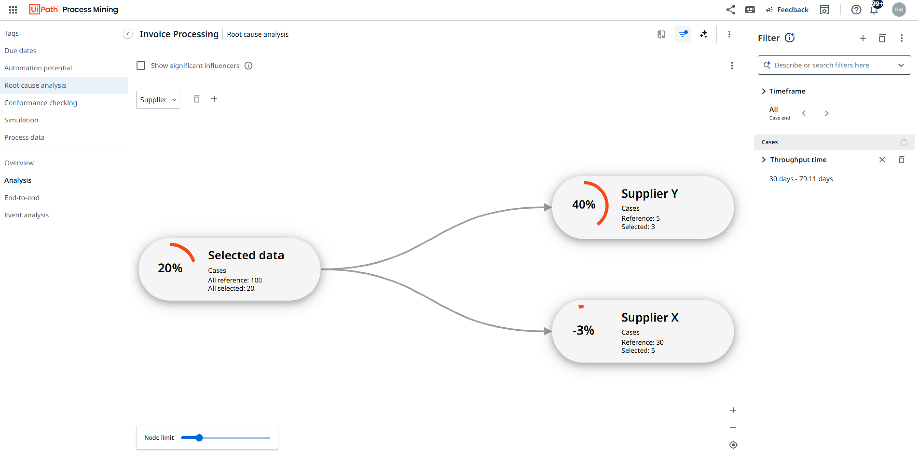

Example
Assume a total of 100 cases. A filter is applied to sort out cases that exceed a throughput time of 30 days. The filter results in 20 cases, equating to 20% of the total. This percentage is set as the "Reference %" or essentially, your baseline.
When aggregating, for instance, by Supplier, an influence percentage is displayed.
Consider Supplier X having a cumulative total of 30 cases, of which only five cases exceed a throughput time of more than 30 days. This means that 17% of the cases related to Supplier X have a long throughput time.
The influence percentage is computed based on the difference between the calculated % of cases exceeding the set throughput time (in the given example, 17%) and the Reference % (20%). In this scenario, the influence percentage equals -3% (17%-20%= -3%).
The following illustration shows the result in the Root cause analysis graph.
Root cause analysis example
Next, consider Supplier Y has a total of 5 cases. 3 of these cases have a throughput time that exceeds 30 days (60%). In this scenario, the influence percentage of this would be 40% (60% - 20% = 40%).
