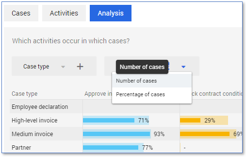

In the example below, a metric Number of users is added to the metric selector of the Process – Process - Analysis dashboard.
See illustration below.

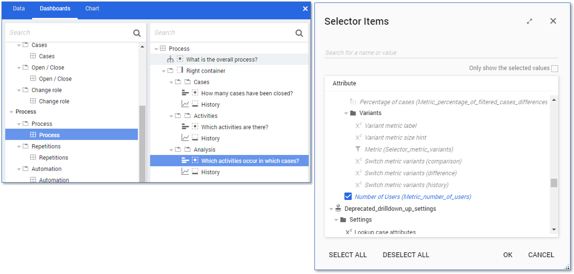

Locate the Process menu and click on the chart Which activities occur in which cases? . See illustration below. |
| 3 |
Go to the Chart tab. |
| 4 |
Double-click on the metric Metric(Selector_metric_filtered_cases) selector in the Header controls of the chart. Note: You can locate this selector by searching for it in the Data tab. |
| 5 |
Right-click on the Selector items field and select Add… . |
| 6 |
Select the Number of users metric and click on OK . See illustration below. |
The selector now contains the new metric as an option.

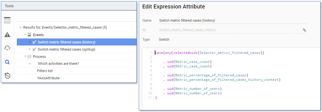

| 2 | Right-click on the Metric Selector_metric_filtered_cases) and select Advanced - Show references…. TheTools panel opens showing all the locations where the selector is used. See illustration below. |
| 3 | Double-click on Switch metric filtered cases (history) to edit the expression. |
| 4 | Add the following lines after the uid(Metric_percentage_of_filtered_cases_comparison) to the Switch metric filtered cases (history): , uid(Metric_number_of_users) , uid(Metric_number_of_users). See illustration below. |
| 5 | Repeat step 3 and 4 for all selectors listed in the Tools panel. |

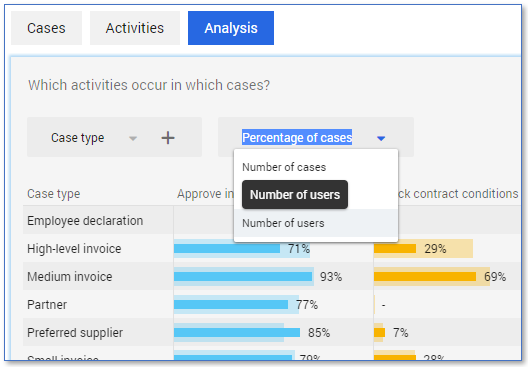

The selector for the Activities and the Analysis dashboards in the Process menu now contains an additional metric. See illustration below.
