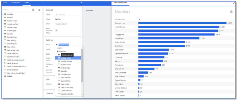

Adding data to a bar chart
Follow these steps to add data to a default bar chart.
| Step | Action |
| 1 | Click on the chart to select it and go to the Chart tab. |
| 2 | Click on none next to Rows and select an attribute from the table item list. |
See illustration below.
After selecting the attribute, the dashboard is split in different bars and after each bar the number of records per row is displayed.
In the above example, the dashboard now shows the number of records per Invoice owner.

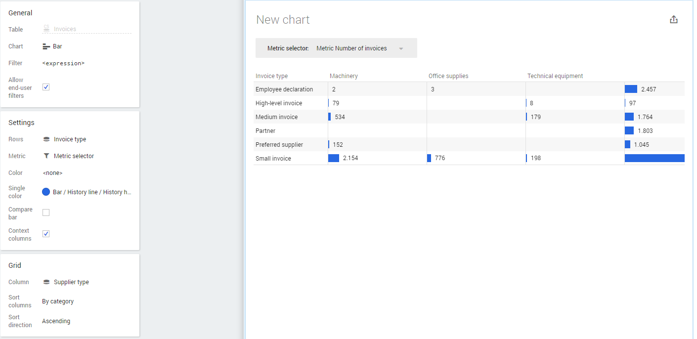

Splitting the chart
You can split the data on the chart by adding columns. Select an attribute from the Column drop-down list in the Grid panel to split up the data by the selected attribute and display the information in different columns. See illustration below for an example where the data is split up per Supplier type.

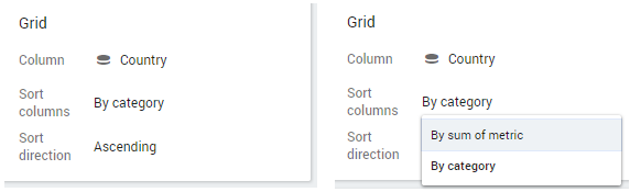

Column sorting
By default the data is sorted alphabetically by category in ascending order. The options in the Grid panel enable you to change the sorting of columns and/or the direction. See illustration below.
Since the sorting applies to columns, the Sort columns and Sort direction options are only available if the Column attribute is set in the Grid panel.
If you select the By sum of metric option from the Sort columns drop-down menu the data in the chart is sorted by the sum of the metric values of the metric displayed in the chart. The Sort direction option enables you to select whether the data should be sorted in ascending or descending order.

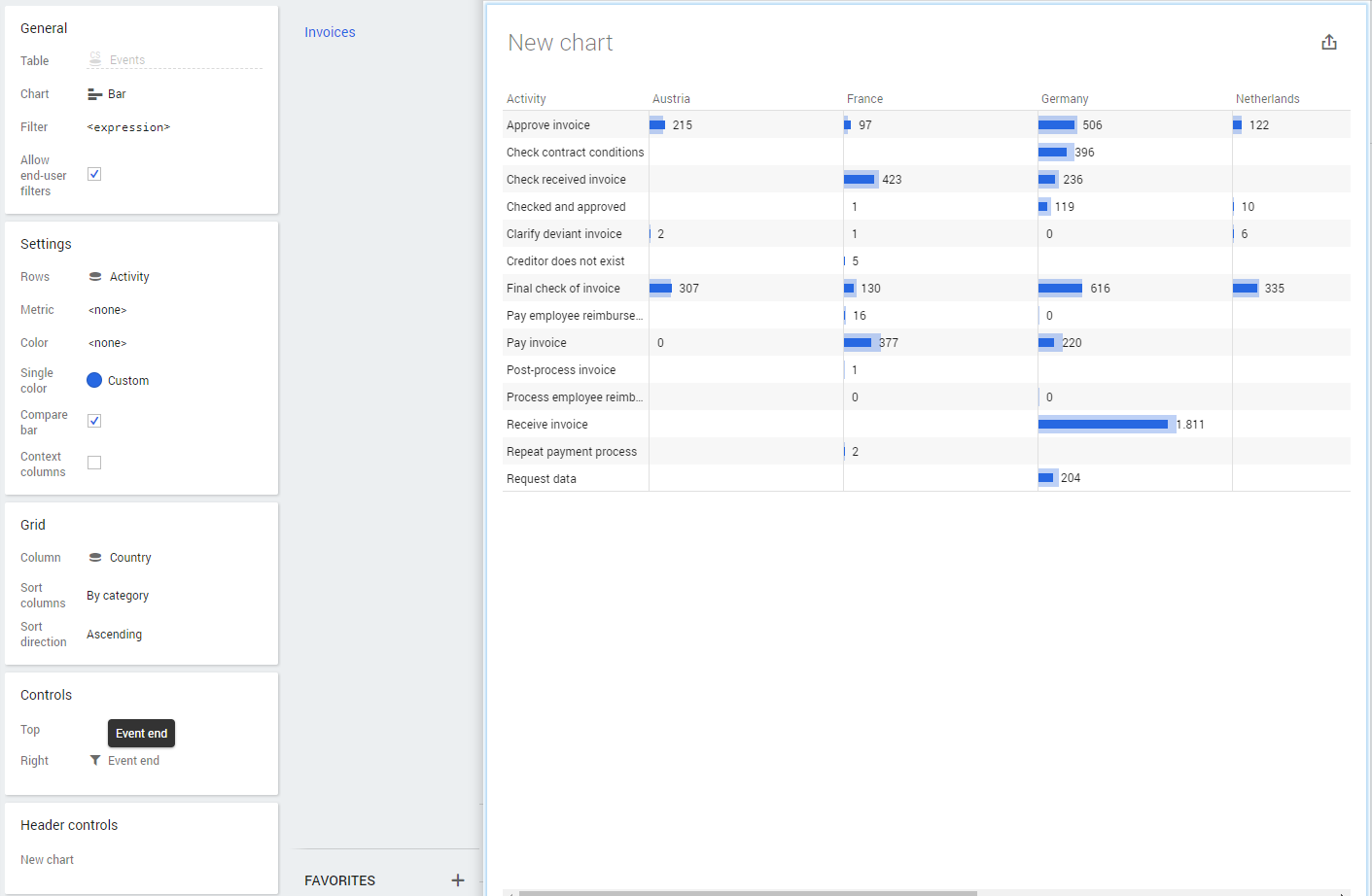

Adding a compare bar
It is possible to add a compare bar to the chart which can be used to compare periods. In this case, you must create a period filter and add it to the dashboard. See illustration below for an example.
The dashboard contains the Event end period filter and the results or the selected month are displayed. The results of the previous month are indicated by the light-blue colored bar, which allows users to compare the values between the two periods.
Follow these steps to add a compare bar to the chart.
| Step | Action |
| 2 | Select the Compare bar option in the Settings panel. |
| 3 | Create a period filter and drag it to the Right level in the Controls panel. |
If you select the Compare bar option, the compare color is automatically determined based on the chart colors. If you want to change the compare color, you must change the color in the period filter.

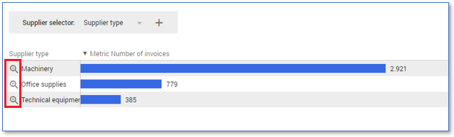

Adding a drilldown
You can define a drilldown attribute for a main attribute. Both the main attribute and the drill-down attribute must be present in an attribute selector on the chart and the selector must be on the X-axis.
The attribute selector is used as a level in the chart. If the attribute that is selected in the selector has a drilldown attribute defined for it, a drilldown icon is added to the bar chart.

The drilldown icon is added to the bar chart. See illustration below.
When a user clicks on the drill-down icon in the chart, the drilldown attribute is automatically selected in the attribute selector and a filter based on the top level attribute is created the Filters panel.
To drill up the user must select the main attribute from the attribute selector, or use the Back button in the web browser. This automatically removes the filter that was created from the drilldown.
Adding context columns
You can define metrics that determine the context of the main metric to provide a better understanding of the main metric displayed on the dashboard. Contexts are displayed as tooltips on charts. On bar charts, contexts can also be added as additional columns. This enables users to sort on the contexts.
See Contexts for more information.

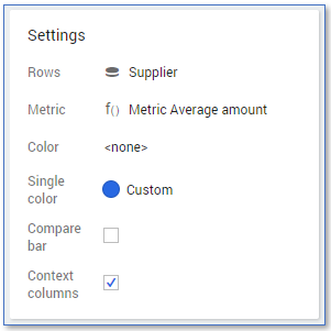

Follow these steps to create a bar chart with context columns.
| Step | Action |
| 1 | Create a metric and define the context metrics. |
| 2 | Click on the chart to select it and go to the Chart tab. |
| 3 | Click on none next to Rows and select an attribute from the table item list. |
| 4 | Click on none next to Metric and select the metric from the table item list. |
| 5 | Make sure the Context columns check box in the Settings panel is selected. See illustration below. |
