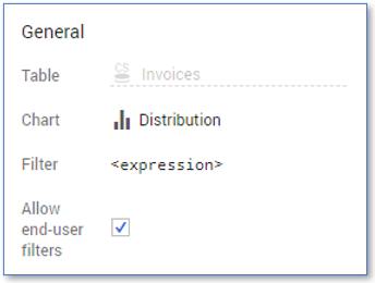

The Chart tab displays the properties of a selected chart. The General panel contains properties that are available for all charts. See illustration below.
Below is a description of the properties in the General panel.
| Property |
Description |
| Table |
The table on which the chart is based. This table contains the main attribute that is displayed in the chart. |
| Chart |
Enables you to select the type of the chart. |
| Filter |
Enables you to enter an expression that returns a Boolean value to filter data from the table before it is provided to the chart. Note: The syntax of the expression should be similar to a per record expression. See Record Expressions . |
| Allow end-user filters |
Enables you to indicate whether end-user filters can be defined for the chart. |

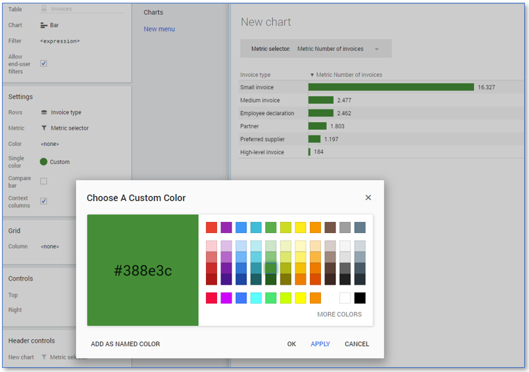

Follow these steps to change the color of the bars in a bar chart.
| Step | Action |
| 1 | Click on the chart and go to the Chart tab. |
| 2 | Click on Color icon next to Single color. |
| 3 | Select a color from the Predefined colors list, or click on Custom... to select a new color from the color picker. See illustration below. |
Single color is only available if Color is set to none.

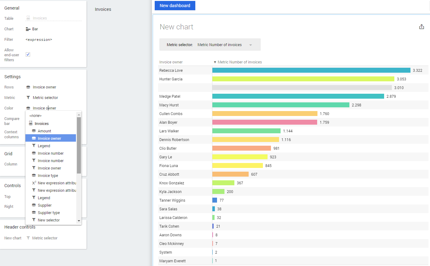

You can also use multiple colors in the chart by selecting a color scheme. Follow these steps to use a different color scheme for the bars in the chart.
| Step | Action |
| 2 | Click on none next to Color and select an attribute from the table item list. |
The colors in the chart are changed according to the color scheme that is defined for the selected attribute. See illustration below.
