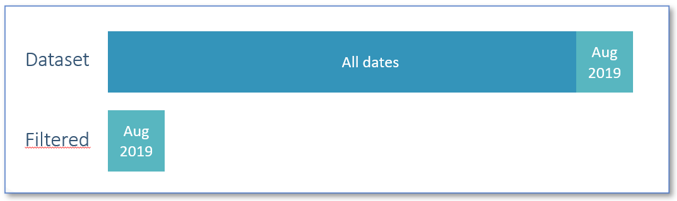

Data Scoping
Limiting the number of records that will show up in the tour dataset will not only improve the performance of the application, it will also improve the comprehensibility of the process and in turn, improve acceptance by the business.
The scoping of the data can be done in the Connector.
One of the options for scoping is to limit the time frame to look by filtering out dates or periods. For example, you could limit the timeframe from 10 years to one year. Or from 1 year to one month. See the illustration below.
docs image

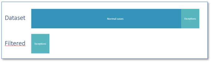

Focus on Outliers
In other instances, the outliers may be the key area to focus on. If your process is going well or you adopt Six Sigma methodologies, you want to focus on the things going wrong. Instead of showing all the cases going right, you only show the cases going wrong.
docs image

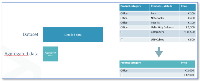

Pre-aggregation
Pre-aggregation is a technique that is employed by many BI tools to gain insights into large data volumes. It involves aggregating data over specific attributes to reduce the number of records in a dataset. In BI this would typically be summing the value of each supplier, so only have one record for each supplier.
docs image
Process mining requires more configuration, but a starting point is to only aggregate on process variants. For each variant you would have one case record and a related number of events. This can significantly reduce the data volumes.
To show correct results you would also have to show how many records each variant represents, for the event ends you could use a median duration of each event. Aggregating only using variants might be too high so it would be wise to check most common filters used, e.g. a combination of variants, case type and month of the case end (to show trends over time).
However, adding attributes has a quadratic effect on the number of records so this requires a careful balance between performance and use case.
Pre-aggregation is most applicable for an overview of your process and spotting general trends.

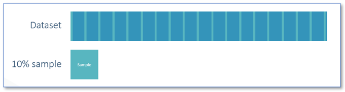

Sampling
Sampling is a technique where you take a percentage of the cases and their events happening in a specific period. You can for instance set that only 10% of all cases and their events are shown. In this way you still have exceptions or outliers since each case has a similar chance of showing up in the dataset.
See illustration below.
docs image

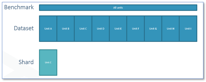

Data Sharding
Data sharding is a technique of the data scoping solution, which allows organizations to split up the data into multiple datasets, rather than just slicing off one part. This setup does require additional configuration since the application needs to be split up by using modules and multiple smaller dataset need to be exported from the connector.
With data sharding, the original dataset is divided into multiple shards. The smaller each shard is, the faster it will be. When a user logs in to the application, only the applicable data shard will be loaded.
A typical unit for sharding would be “Company code” or “Department”. For example, in the case of 50 company codes, each shard will contain one company code, and essentially be about 50 times faster than the original dataset.
See the illustration below for an overview of sharding.
docs image
