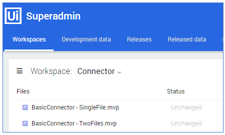

| 8 | Right click in the new workspace and select Upload file…. |
| 9 | Drag the BasicConnector.mvp file to the Upload file dialog and click on OK. |
| 10 | Click on the menu icon in the Workspaces tab and select Commit… to commit your changes. |
note
You can also drag the file directly onto the Workspaces tab.
The Basic Connector file is uploaded to the Workspace. See the illustration below for an example.
