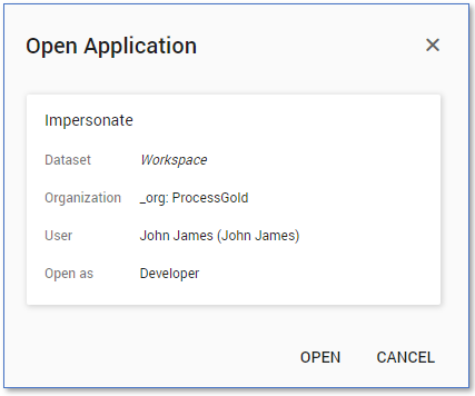

Warning: Table … Has Been Reloaded/updated Locally.
Cause
This warning is displayed when the connector was opened with an input dataset, without reloading the table. The dataset is locally updated in this session, but the input dataset will not have that new reloaded data.
Solution
Select Workspace from the Dataset list in the Open Application dialog when opening the connector. See illustration below.

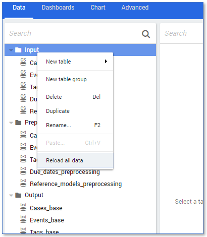

docs image
Go to the Data tab in the development environment, right click on the table list and select Reload all data from the context menu. See illustration below.
