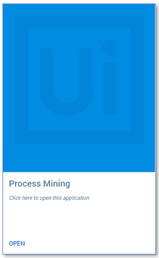

A module defines how the application is presented to the end user when starting the application.
Normally an application contains a single module, which is automatically created when the application itself is first created. See illustration below.

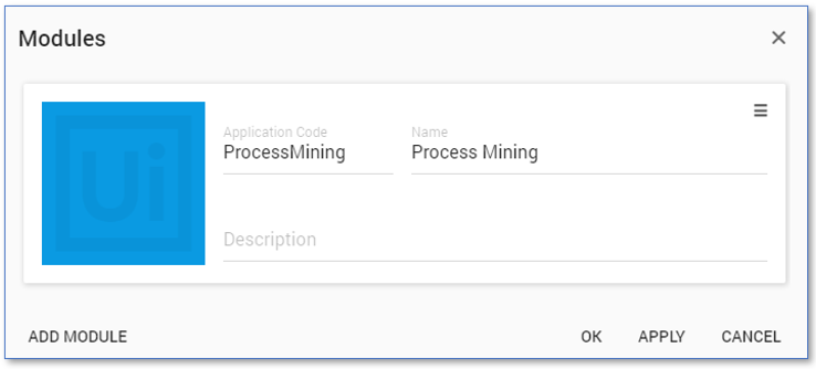

Modules dialog
In the Modules dialog, you can add new modules. You can also change the name and description of existing modules.
Follow these steps to display the Modules dialog.
| Step | Action |
| 1 | Click on the logo icon in your app development environment. |
| 2 | Select Modules.... |
The Modules dialog is displayed. See illustration below.
The Name and Description entered in the Modules dialog are displayed on the end user’s application page. The Application Code is used in the URL for end users and developers. See illustration below.
The Code,Name,Description, and the image of a module can be changed within an application in the Modules dialog.
Changing the application code of the module has implications for releasing the app. If a code is changed, there will be no generated cache for the new application code. This means that after activating the release, it will not be accessible by end users until a new cache is generated. Additionally, all user rights are linked to the application code and will need to be set up again. Furthermore, changing the module code will break existing end-user Favorites. Before making changes to the application code of a module, discuss the implications with your Application Manager.
