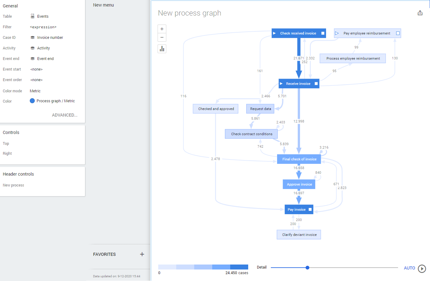

Creating a process graph
Follow these steps to create a Process graph.
| Step | Action |
| 1 | Got to the Dashboards tab and create a new dashboard on an event-based table. |
| 2 | Right click in the dashboard item list and select New process graph and then the events based table. |
| 3 | Go to the Process graph tab. |
| 4 | Drag the attribute representing the Case ID, for example Invoice number, to Case ID in the General panel. |
| 5 | Drag the attribute representing the Activity, to Activity in the General panel. |
| 6 | Drag the attribute representing the Event end to Event end in the General panel. |
See illustration below for an example.

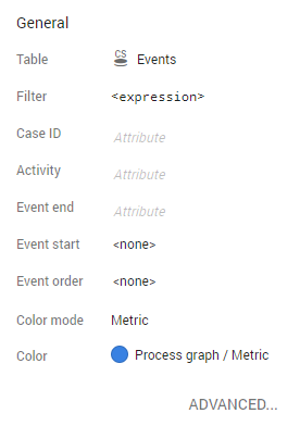

The Process graph tab displays the properties of a selected Process graph. In the General panel you can enter the properties that define the Process graph. See illustration below.
Below is a description of the properties in the General panel.
| Property |
Description |
| Table |
The table on which the Process graph is based. This table contains the attributes that are displayed in the Process graph. |
| Filter |
Enables you to enter an expression that returns a Boolean value to filter data from the table before it is provided to the Process graph. Note: The syntax of the expression should be similar to a per record expression. See Record Expressions . |
| Case ID |
Enables you to select the attribute that is a (unique) identifier for each case. Note: This is a mandatory property for the Process graph. |
| Activity |
Enables you to select the attribute that represents the activities that comprise the process. Note: This is a mandatory property for the Process graph. |
| Event end |
Enables you to select the attribute that defines the end time for each event. Note: This is a mandatory property for the Process graph. |
| Event start |
Enables you to select the attribute that defines the start time for each event. |
| Event order |
Enables you to select the attribute that defines the order of the events. See Event order |
| Color mode |
Enables you to select the color map to be used for the Process graph. |
| Color |
Enables you to select a different color for the Process graph. See Changing the Process graph colors |
| ADVANCED... |
Displays the Advanced Process Graph Settings dialog. |

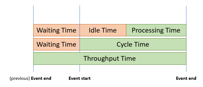

Timestamps
The duration of the event is taken as the time between two event end timestamps that follow each other. In this case, events will have no waiting time. The graph will show the throughput time of events. Each transition shows the throughput between the two activities, while each activity shows the average throughput time of all incoming transitions.
When both and Event start and Event end are defined, the duration of the event is known. In this case, the graph will show cycle time. Note that in this case the transitions in the graph always show the same value as their target activity, the waiting time is not taken into account.

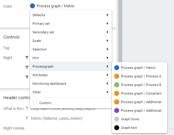

Changing the process graph colors
When a new Process graph is created, the default color is used. It is possible to use a different color scheme in the Process graph to differentiate between values.
Follow these steps to change the color of the Process graph.
| Step | Action |
| 1 | Click on the Process graph and go to the Process Graph tab. |
| 2 | Click on Color icon next to Color in the General panel. |
| 3 | Select a color from the predefined colors list. See illustration below. You can also click on Custom... to select a new color from the color picker. |

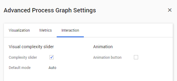

Process graph animation
By default, when you create a Process graph the Animation button is visible. This button enables end users to start the Process graph animation. You can remove the Animation button in the Advanced Process Graph Settings.
Follow these steps to remove the Animation button from the Process graph.
| Step | Action |
| 2 | Click on ADVANCED... in the General panel. |
| 3 | Go to the Animation section on the Interaction tab. |
| 4 | Disable the Animation button check box. See illustration below. |
