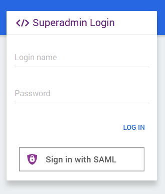

If SAML is enabled and correctly configured, a button is displayed at the bottom of the Login page. See the illustration below.

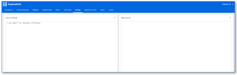

  1. Go to the Settings tab of the Superadmin page of your UiPath Process Mining installation to configure the Server Settings. See illustration below.

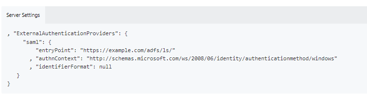

Below is an example of the Server Settings with the ExternalAuthenticationProviders setting with the saml object for a basic ADFS configuration.

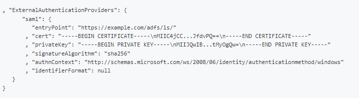

Below is an example of the Server Settings with the ExternalAuthenticationProviders setting with the saml object for an ADFS configuration with two-way certificate checking.
