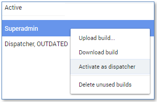

1Go to the Buildstab of the Superadmin page of your UiPath Process Mining installation.
2Right click in the list on the build that has been uploaded and select Activate as dispatcher.
See illustration below.
docs image
The entire UiPath Process Mining installation is updated.
