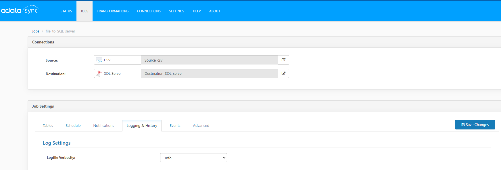

CData Extractions
For more details on the CData Sync job executions, go to your CData Sync instance and check the Logging & History tab of your job. See the illustration below.
To log more details, set the Logfile Verbosity to Verbose and run the extraction script extraction_cdata.ps1 again.
