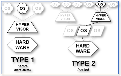

Virtual Machines
There are two types of virtual machines. The type of virtual machine determines whether the virtual machine has direct access to the hardware.
See illustration below.
docs image
Type 1 hypervisors can run on bare metal. Type 2 hypervisors need additional OS to run, which may reduce the amount of resource at disposal of the VM which impacts the performance.
