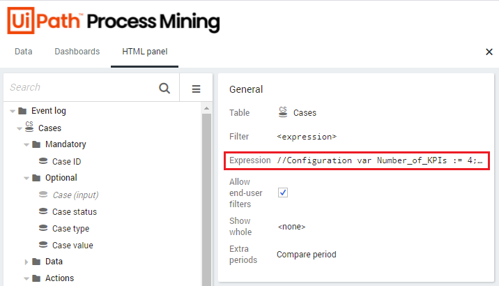

Follow these steps to change the number of elements in the context bar.
| Step | Action |
| 1 | Click on the expression in the Expression field in the General panel to edit the expression. |
| 2 | Set the integer in the Number_of_KPIs variable to the number of elements you want to display in the context bar. |
See the illustration below.

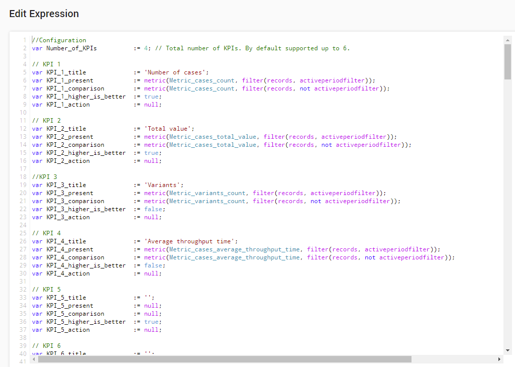

Configuring the individual elements
The configuration of the individual elements consists of setting a number of variables.
| Element | Description |
| KPI_n_title | The name of the element or KPI to be displayed on the context bar. |
| KPI_n_present | The actual metric computed to be shown for the selected period. |
| KPI_n_comparison | The comparison metric that is shown next to the actual metric. Usually, this is a metric containing data outside of the selected period. |
| KPI_n_higher_is_better | The value that determines if an increase for the KPI should be considered to be an improvement. This influences the color or the comparison KPI: green - better, red - worse. |
| KPI_n_action | The action that makes the element clickable. By default, actions are not used, but the option to have this configured is available. |
Example
// KPI 1
var KPI_1_title := 'Average throughput time';
var KPI_1_present := metric(Metric_cases_average_throughput_time, filter(records, activeperiodfilter));
var KPI_1_comparison := metric(Metric_cases_average_throughput_time, filter(records, not activeperiodfilter));
var KPI_1_higher_is_better := false;
var KPI_1_action := Action_analyze_total_case_value;

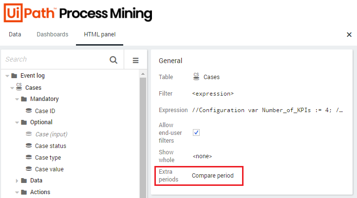

Extra period
Make sure that you enable an Extra period if you create another bar on a dashboard or copy one of the existing bars.
Follow these steps to add an extra period.
| Step | Action |
| 1 | Open TemplateOne in your developer environment. |
| 2 | Go to the dashboard for which you want to configure the context bar. |
| 3 | Click on the context bar. |
| 4 | Go to the HTML panel tab. |
| 5 | Click on nonein the Extra period field in the General panel and select the extra period. |

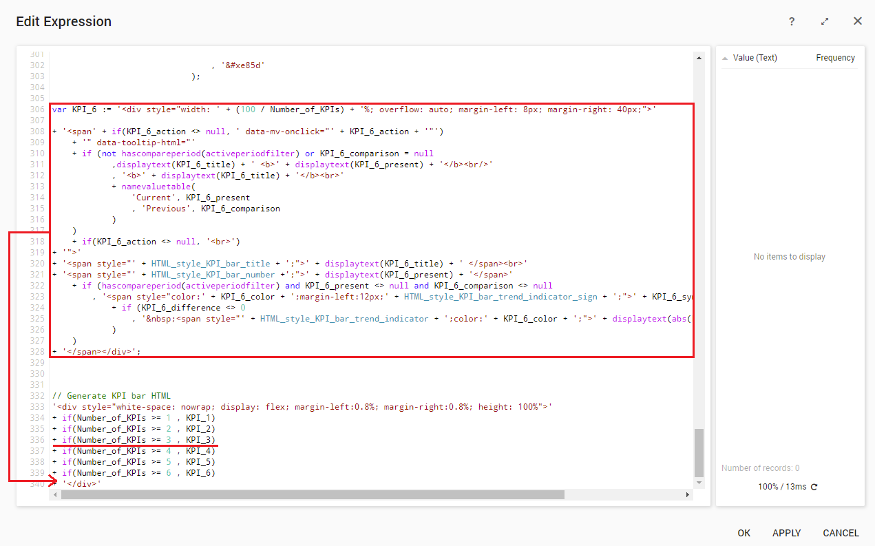

Ading additional elements
If you want to configure more than 6 elements for the context bar, you must copy the set of elements and adapt these for each new element. You must also copy and adapt the code for each new element and add it to the list of KPI's at the end of the expression. See the illustration below.
